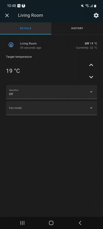

July 19, 2025Jul 19 On 2022/08/24 at 12:07 PM, shovelhead said:Thanks - I eventually managedResurrecting an old thread here. Did you ever figure this out?I have 2x JASA aircons. Both worked with full functionality in the JASA app. But pulled into smart-life or tuya smart and then via those integrations in HA ends up with the upstairs unit not having fan speed control. When pulled into HA from Tuya integration it shows the fan up/down function where the other unit shows the fan speed. Was it as simple as enabling entities? Edited July 19, 2025Jul 19 by BobTheDinosaur
July 25, 2025Jul 25 Author @BobTheDinosaur I never managed to pull in the fan speed control. I have found though that if I set the fan speed via the remote control and I simply switch the unit on or off via HA, it retains that fan setting until a physical ac reset or change via the remote control. 🫤
