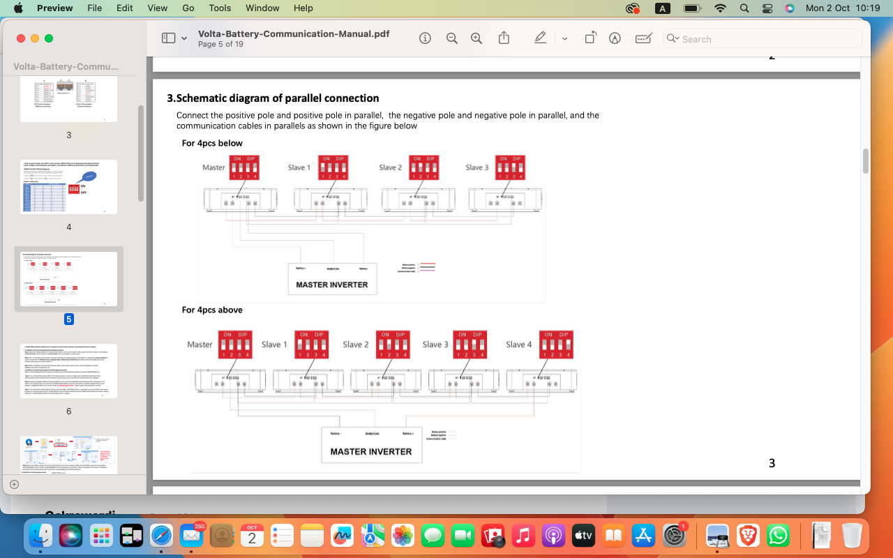

Yes, Junlee manual says nothing about the baud rate. But the Volta's manual (their BMS uses same software for RS232) has something on that. I attached the page from the manual. So it's even more confusing now. I wrote the email to Solar Assistant yesterday with all this story, hope they have the solution.
