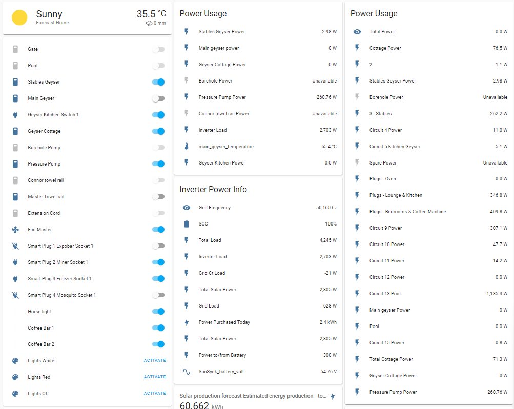

What inverters are you using and would you be able to integrate into Home Assistant, would be useful to have total power consumption and what the grid frequency is so you can detect load shedding.

What I would then do is pair all the switches up to your primary Ewelink account, then create a secondary account for Home Assistant to use (or you could do it directly in Node Red if you preferred) and share all the switches with that account. Unfortunately only one device can access the API per account but you can get around this by just sharing the devices over multiple accounts.
Install Home Assistant onto a Raspberry Pi/INtel NUc/Desktop computer and install the integration for Ewelink/Sonoff.
You would then be able to monitor the power draw through each circuit and switch them off individually either from your phone or from the Home Assistant  console.

Simplest would probably be to use the Home Assistant integrations (which were recently upgraded.) These would allow for the automatic disconnection of the units when they exceed the permitted load during load shedding.

I have a similar system set up at my house that monitors all loads in the house.
