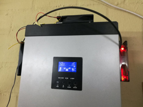

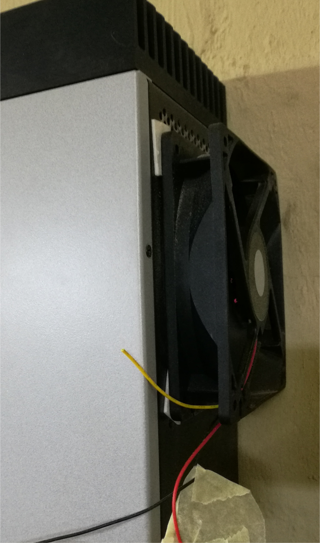

July 5, 20178 yr Author despite cool advice, things are heating up on this thread ;-) 25 minutes ago, SilverNodashi said: thermal camera or thermal laser gun were really getting into the star wars gear now, just kidding - it would be very interesting to see the verdicts on this one in the meantime back in peacefortress i surrounded the top of the axpert with three old pc fans [powered by old 12v powersupply, 1.5A] with doublesided tape, sucking air out of the unit - resulting in a near immediate 9C drop!!!
July 5, 20178 yr 52 minutes ago, gabriel said: despite cool advice, things are heating up on this thread ;-) were really getting into the star wars gear now, just kidding - it would be very interesting to see the verdicts on this one in the meantime back in peacefortress i surrounded the top of the axpert with three old pc fans [powered by old 12v powersupply, 1.5A] with doublesided tape, sucking air out of the unit - resulting in a near immediate 9C drop!!! Nice! So now you don't void the warrantee, though the double sided tape residue might be questionable I doubt if the top fan would do much though. Next step would be to put an Arduino on there with it's own themistor and only let the fans come in when the case is too hot - but then you need to find the hottest point, and play around with the code a bit. this could possibly save a couple watts during the night. Unless you run those fans off a 7A or 18A alarm battery with it's own 10W PV panel or something?

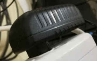

July 5, 20178 yr Author @SilverNodashi 53 minutes ago, SilverNodashi said: Next step would be ... its about there where you lost me i realize the top fan is of hardly any use, i'll remove it - the small power supply [ex router or something, see snap] will be able to relax a bit. i don't worry about the tape residue... zer ar vayz und meanz [pardon my germlish]

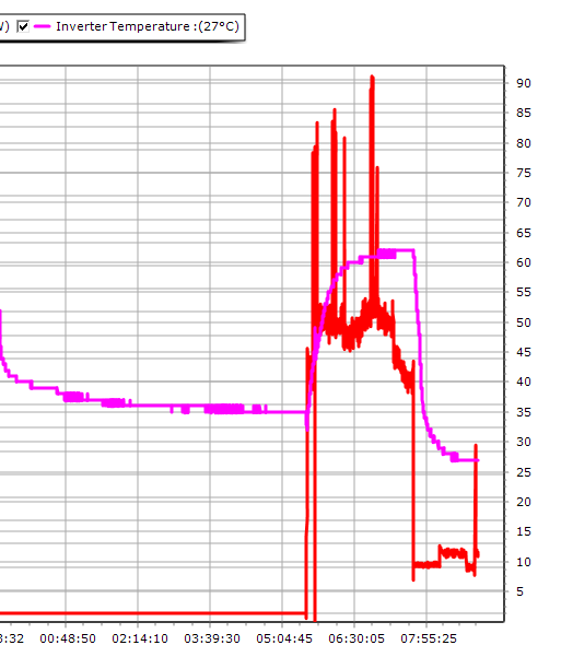

July 5, 20178 yr Author nothing wrong with your grammar, its just that i somehow made it through 'school' without attending those classes - there are other classes i also missed, to my detriment i confess :-) indeed those fans are cheap, between 50 and 150 bucks new and the ones in my pc have been at it constantly for about 5 years so i'll let them go 24/7. the lowest temp my inverter ever hit [apart for a 'glitch' of 39] has been 43, like at 03:00, now it is comfortably cruising at 46; but let us not get exited, the proof of the pudding will only be visible when the grid kicks in to charge the batteries later today when customary peaks of 70 were common. i'll post feedback at that time. cya

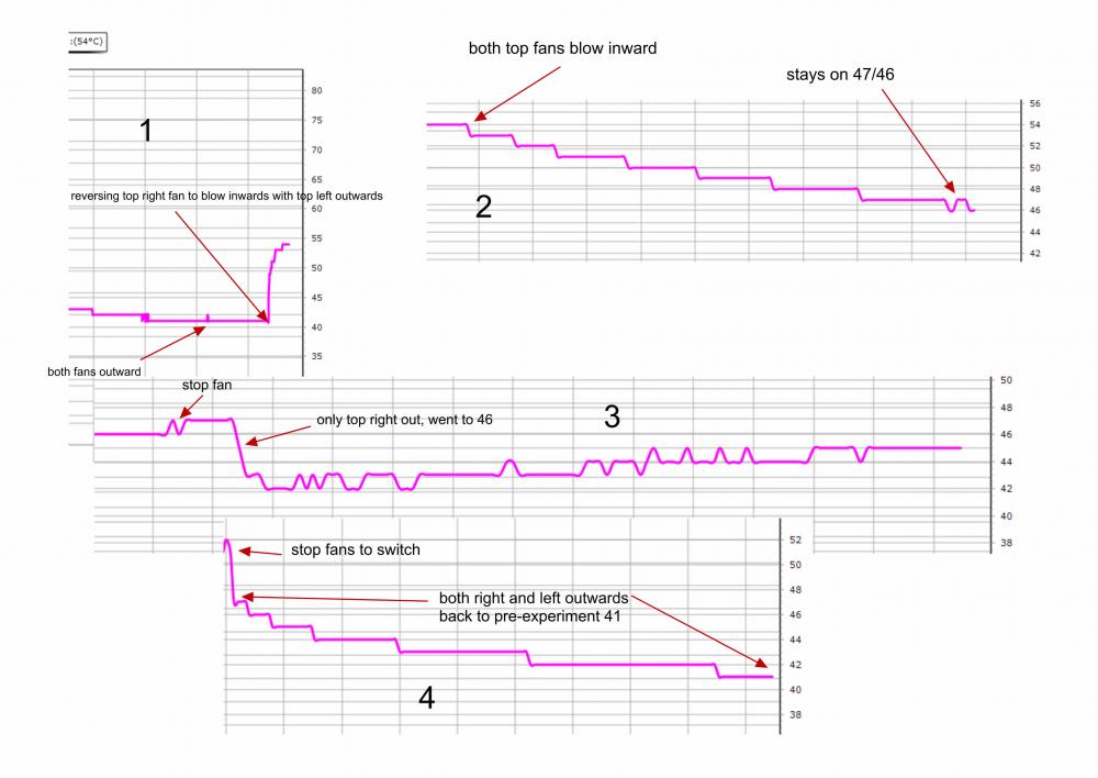

July 5, 20178 yr 4 hours ago, SilverNodashi said: in the meantime back in peacefortress i surrounded the top of the axpert with three old pc fans [powered by old 12v powersupply, 1.5A] with doublesided tape, sucking air out of the unit - resulting in a near immediate 9C drop!!! Can I suggest that you blow air in from the top! This may sound counter-intuitive but the air flow is out the bottom of the inverter without the fans reversed and now we have air out both top and bottom and no real airflow in. Yes it will get in somewhere but you may just end up with a dead spots due to turbulent airflow.

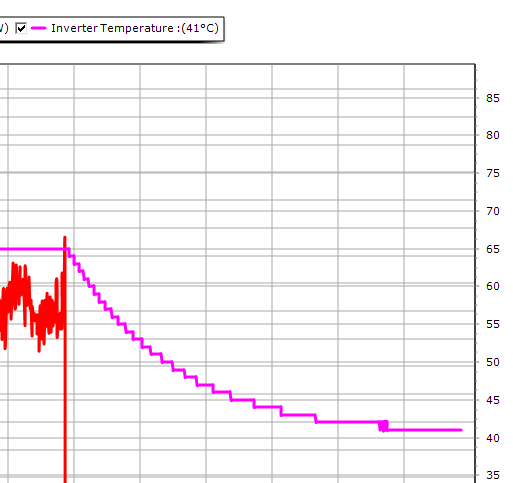

July 5, 20178 yr Author thanks @Chris Hobson, i'll try that - it makes sense. in the meantime though feedback on the present situation. max temp during load came down from 69/70 to 65; whereas in the past it dropped to about 53/55 it is at present 41 [i.e. when load dropped]. conclusion: there is meaningful improvement! now for top fan reversal...

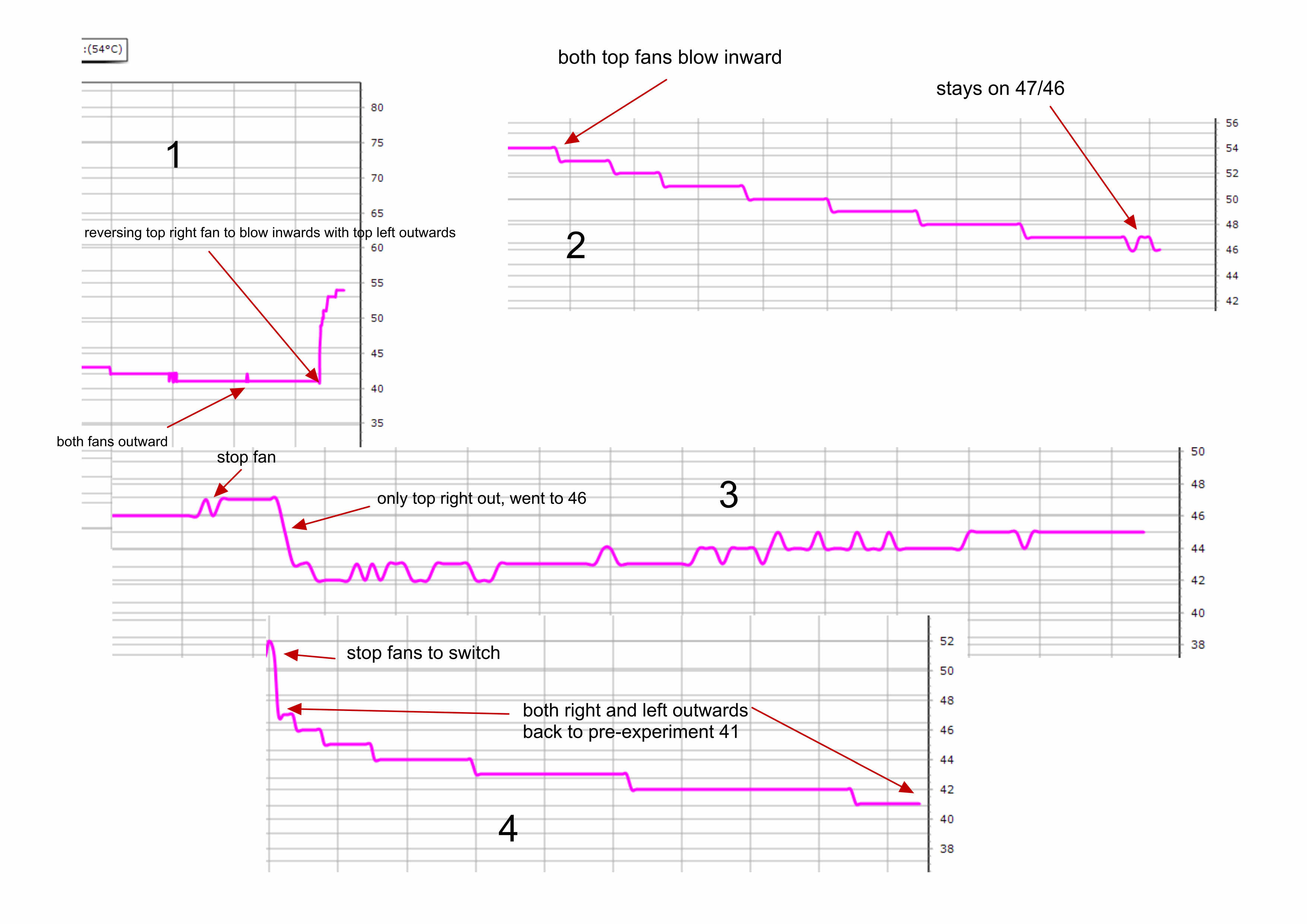

July 5, 20178 yr Author not knowing the inside 'aerodynamics' of the axpert i did the following, see jpg prior to experiment both top left and top right fans blowed outward - result 41C top right in top left out - 54C [skipped opposite] top left in top right in as @Chris Hobson suggested - 47/46C took top left off, top right out - 46C [skipped opposite] back to both out - 41C, now, 60 odd min later it is at 39C if the thermistors are placed on or very near the heat bearing elements moderate airflow should not have too much influence on them. we should take note that the heat sink is at the top, designers must have anticipated correctly that heat would rise and should be dissipated from there, something the top fans are in fact now doing [but artificially and in so doing 'flat spots' might be created, i admit]. i have repeatedly touched the heat sink not feeling any warmth... maybe it is very effective? the other thing is, will the reversal of the bottom fan not also create 'flat spots'?

July 6, 20178 yr Morning Gabriel Having conducted your tests I would say keep them in your original orientation. Just as a final test see what happens under load when the Axpert's own fans are running too. 6 hours ago, gabriel said: we should take note that the heat sink is at the top, designers must have anticipated correctly that heat would rise and should be dissipated from there, something the top fans are in fact now doing [but artificially and in so doing 'flat spots' might be created, i admit]. i have repeatedly touched the heat sink not feeling any warmth... maybe it is very effective? The heatsink at the top serves only the SCC. It should be warm to hot during the day and cool at night. A week ago I would not have been able to tell you that but I now have had the advantage of tearing @Virgil's Axpert apart.

September 8, 20178 yr Author 40 minutes ago, pilotfish said: what was your final fan orientation that gave best results? I would like to do something similar. two pc fans driven by old [phone charge?] 12v adapter stuck on either side with double sided tape SUCKING AIR OUT OF UNIT . drop in temp at least 10c - no untoward effects [yet] , fans on 24/7, they are cheap enough and last for years
