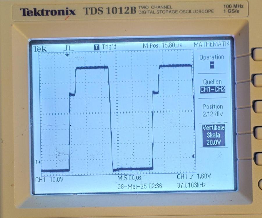

Hi Powerforum and @BritishRacingGreen,
thanks for this repair thread and all the useful information.
I also had to repair an MKSIV inverter and replaced
eight MOSFETs and some of the 22 ohm resistors.
Now the inverter is working again, but not fully.
The second MOSFET string, which was most damaged,
have a strange rectangle switching signal, see attached picture.
Does anyone know where this behavior is coming from?
Which issue or faulty component cause this?
Thanks, regards and vy73
Hans
I assume that this is at the high voltage end of the DC-DC converter. [ Edit: Sigh. It seems I didn't consider the waveform photo carefully. ]
My wild guess would be some of the push-pull transistors between the SG3525 and the isolating transformers. Or possibly those small MOSFETs that are supposed to turn the DC-DC converter off when not needed.

Hi,
tnx for your answer. No, this is not on the high voltage side, but on the 48 V battery side.
I also measured this strange rectangular signal coming from the NSi6602 dual channel MOSFET gate driver chip. The input signal to this chip is ok (but with much noise...)
Was such behavior seen before? What can be done to get the rectangle right?
regards
Duh, sorry. I don't seem to have considered your waveform photo carefully.
So this is the output of one of the half bridges containing the second string of MOSFETs? With respect to battery minus? And CH2 on battery minus? The amplitude seems too high, at around 75 V P-P.
Is the other set of MOSFETs replaced in the same half-bridge? If not, the other halves should be replaced (i.e. all 16 MOSFETs), as they likely sustained some damage when the first set saw massive over-current.
What part of the circuit is this in? Sorry, I'm not as familiar with the MKS IV.
