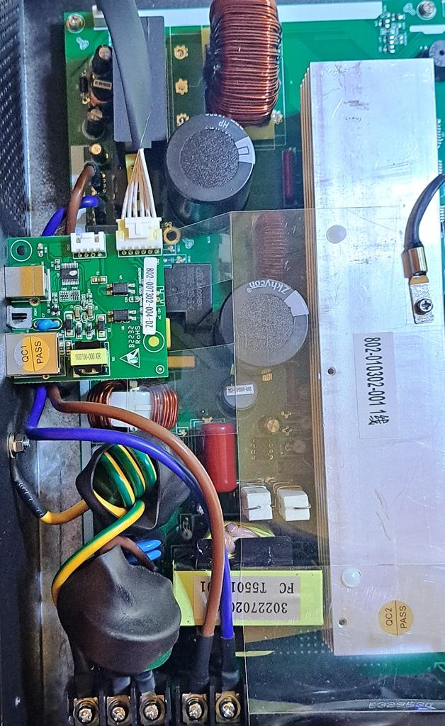

    Yesterday I nearly decided to stop my journey , pack my solar suitcase, delete my forum account, and walk off in the sunset. I have done so much homework in order to leave very little if any to t
That's a board for accelerating relay switch-over. I believe that when you use the AC input range (UPS? I forget), then this board is somehow involved. It seems like it has damaged parts on it. There seem to be SCRs or TRIACs on that board; it's pretty mysterious to me. It looks like the DSP squirts some I²C or SPI data at the control chip on this board.
I believe that it's possible to run without this board, though relay speed may be affected, and strange things may happen if you select the faster AC input range option. It may be possible to buy a replacement board. I don't know if those boards are different between 5 kVA models and 8+kVA models, so you need to be careful to get the right version of the board.
Sorry I can't be of more help;  these boards rarely seem to fail. I bet that makes you feel special 😧.

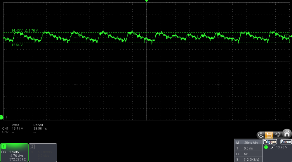

My initial guess is bad output cap...as ripple increase due to largeload....cap fail to supress them...one spike registered as high voltage....very logical ...
This model is for a company...installation company i repaired 10 pces they all ok...however this one only have problem ...i also suspect the input fets...as all first 9 pces all repaired with hy3712  super solid chinrse fet...
But this last is mixture of hy3712..and 85h160 fet that i survived from bad inverter
So i guess there sort of unbalance creating the wavform in the primary due to may be diffeent threshold on voltage
Just a guess based on practical clue...with9 pcea working and one not
