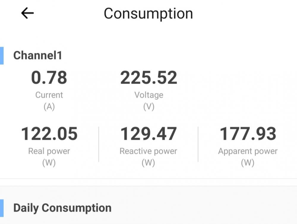

November 6, 20223 yr Author Yes so I also seem to think balancing. I asked as to when they should be balanced and he stated 3 cycles, it did 3 according to the display but I could then see each cell was not all the same. I am not sure if tolerances but still. I did notice the following a day a bit better balance which is good. I also added in some Sonoff smart stuff to swich off fridges and it at least got the batteries to last the time gap of 2hr15 (they came back on early). Today in what ever gaps I had was reading about power factor and actually that we need to take that in when calculating run time of batteries. I didn't know this as thought the inverter took care of it and then we could work with direct watts but turns out we need to account for reactance. So when I see 2100watts I need to add 0.80 which is 2625 and the the inverters own consumption of I believe 400watts (Sunsynk 5kw). This then brings it to 3025. 7000/3025 =2.3 but we can't use all 7000wh so 20% is 5600 so then 5600/3025 =1.85... just shy of 2hr make which is what I got. I assume the battery cut off at 20% and also it's a 7100wh but I use 7000wh. Anyway all this is very interesting and now applying reactance for battery capacity is a new thing for me and intresting. So far it checks out to a degree. Also it's not always 0.80 powerfactor so that will also dictate more or less backup time. But I must add I am still learning so if anyone can add to or dismiss anything please do so as then we can all learn
November 6, 20223 yr 23 minutes ago, Dylboy said: So when I see 2100watts I need to add 0.80 which is 2625 and the the inverters own consumption of I believe 400watts (Sunsynk 5kw). Ok, slow down there, sunshine... the inverter should not self consume more than 100W, I've seen it vary from 70W on the minimum to probably just about 100W... As for the PF, its a pity the inverter does not give us that figure based on the load, since then one could consider doing power factor correction, maybe one should consider this a project, do PF measurements and dynamic PF correction... What you should base your calculations on is the actual current draw * the actual voltage of the battery at the time of current measurement and then you could work out how much energy the battery provided for the time period in question, of course both of those values will vary over the period you'd want to see what it was actually giving you. As for unbalanced cells, top balancing is generally what one would want, I think, the problem is... 1. Does the BMS actually do cell balancing (some do, some (most?) don't, or if they do they do it poorly) 2. Under which conditions will it do cell balancing? You may need to Absorb at, let's say 55.4V and then Equalize at the same Voltage for 30 minutes or more to let the BMS do cell balancing and then Float at 54.5V or so thereafter. 3. The BMS will normally not care whether you're down to 20% charge remaining or 5%, usually it will disconnect the power, because one or more of the cells has reached a low Voltage threshold. If the cells are badly unbalanced then you may never see even close to the rated power out of the battery... Edited November 6, 20223 yr by Kalahari Meerkat speeling
November 6, 20223 yr Author Ah if that's the case then great, I did think 400watts was massive. I went to the logs in hope there was some power factor but not so I agree it would be great to see that. I will do so, didn't think to look at a certain time and then take that data to get power. Thank you. Yes agreed as soon as one cell is low it shuts off. I want to try go back in the week to see how the balancing is going. I do not know how often or when it does it though. The voltages are set to what he stated. Besides that I want to get a CAN in as well to then allow better communication. I did read a note in a REVOv document about setting the voltage settings in the AGM-V page and then selecting it back to Lithium and also doing the settings there ( only if you don't use a cable) I thought that was interesting and want to test that too however the battery does appear to be reaching the voltages set.

November 6, 20223 yr Power factor won't affect power from the battery that much, it might increase losses, but the battery only supplies the real power part.
November 6, 20223 yr Author 11 minutes ago, P1000 said: Power factor won't affect power from the battery that much, it might increase losses, but the battery only supplies the real power part. That is what I originally thought but now I'm extra confused as then I thought power factor needed to be added to then see how long the battery will last, but if the battery only supplies true power then we only need to use the watts and not apply power factor. Basically them 5kwh battery and a 1kw load would then last 5 hours or close to( Assuming 100% discharge and some heat losses). Unless you mean the 5kwh can supply the 5kw with or without the power factor of the load taken into account? Edited November 6, 20223 yr by Dylboy
November 6, 20223 yr Author In essence which is the correct method to more accurately estimate how long the battery can last. (Basic numbers) Option A: no power factor used. 5kwh battery, 100% DoD, Load: 1000watt (i.e read on back of appliance) constant load. Answer: 5000/1000 = 5 hours. Option B: power factor used Same as above (5kwh battery,100% DoD, Load: 1000 watt(i.e read on back of appliance) constant load. Assumed power factor of 0.90 Answer: 1000w / 0.90 = 1111 watts. 5000kwh / 1111 = 4.5 hours. Which is the better one to use, or rather which is the more correct one and if power factor must even be considered in calculating estimated time duration to sustain the load. I also discounted what the inverter power needs are which is I believe at a max of 100watts. Also temperature I know plays a role but how much I don't know but I want to understand the baby steps first.
