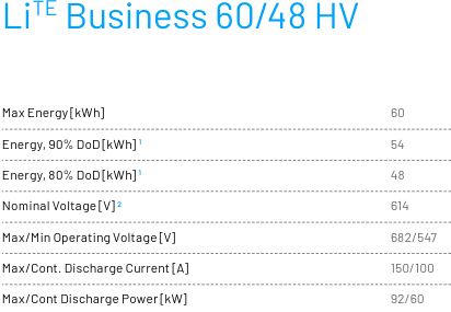

The setup I am referring to is roughly 21kWp of solar per hour, 50kW inverter and then 2x freedom won 60/48HV batteries (614V per battery battery with cont charge current of 100A each)

If the batteries' Voltage is indeed 614V (six-hundred and fourteen Volt) and you are charging at 100A (one-hundred Ampere) at that Voltage, then that would be:
614 V * 100 A = 61 400W aka 61.4kW, which is more than the panels can supply, or the inverter, and since there are 2 batteries with 100A each, according to your writing, that would require 122.8kW to come out of thin air (not out of the solar panels or the 50kW inverter, I'd think) to recharge the batteries in one hour... give or take, so I think your numbers seem off, sure 100A max charging current, but I suspect you never get even close to this number especially per battery, in other words 200A continuous charge current at 600-odd Volt. I'd think you may be charging more like at 20A per battery, maybe, around 20kW or so, and then the batteries would recharge in 5 to 6 hours, assuming a fairly low SOC (10% or so) when the charging cycle starts, I'd think...
so the batteries can be charged at 100A cont. I am not saying that is is charged at that current although it can. So these are the HV batteries rated at 614V, which is correct.
