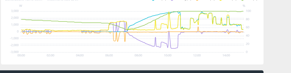

This may vary from product to product, but on mine I see all loads - backed up or not. I just see a total, not individual loads. I suspect it's always like this, but with a little practice you will get to recognise the signatures of devices that you use regularly.
EG here
The total load is the yellow trace. The water heating (heat pump) kicks in at 6:00. We were having a lay in this morning, so the kettle gets it first run only about 9:00. Pool pump kicks in at 9:30, but doesn't run for long because there's load shedding at 10:00. You'll soon get the hang of it.
The game I play with some new claimed time/money saver is to run it the first time when there's no load shedding, and see how that yellow line changes.
