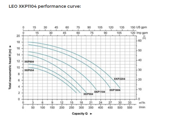

So @Brendonvdh you have a 1kw pump at the moment, typical 1kw performance is +-

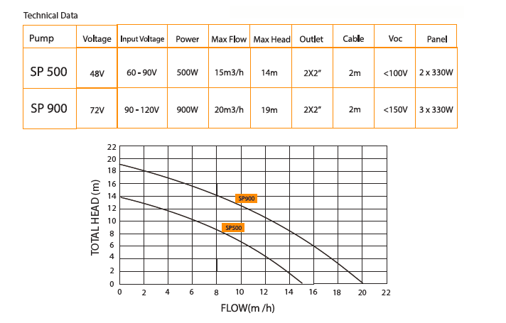

These are the performance ratings for the DC pumps from their website
So you if you want the same sort of performance from your new pool pump you are going to need to get the 900W pump which will still be a bit short but close enough IMO
