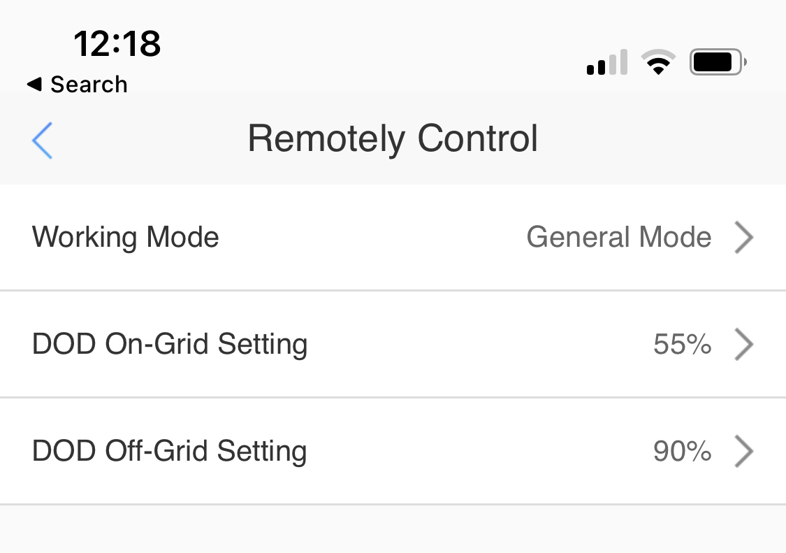

I managed to do this via SEMS app on iPhone. It looks like a Beta function, but it works.
I have attached screenshots
1 - Click on devices
2 - Click on Configure
3 - Accept disclaimer
4 - Screen similar to PV Master options

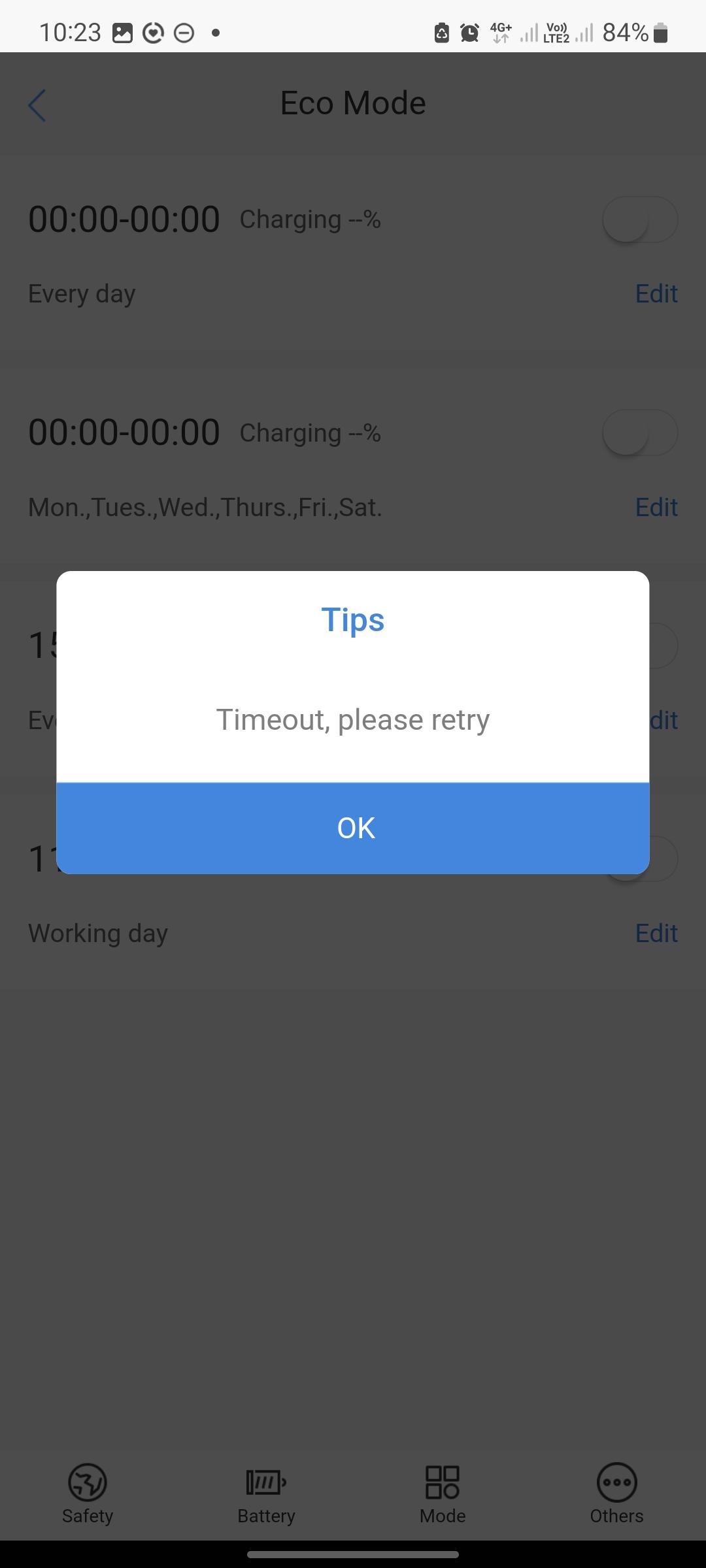

OK... Goodwe managed to give me the installer privileges I need. This was a bumpy road, but we got there. I now get that configuration button in the Sems Portal app.
Problem now is changing the modes. If the inverter is in eco mode already, this shows on the app, and I can access the mode.
First problem: All the rules (charge from this time to that time) are shown as turned off. I can access these, change times and %ages, and those changes take effect (I can see them using the Solar Go app). But I can't change mode (EG from eco to general), and I can't turn on any of the rules for eco mode. When I try to do those things I get an error message "Timeout, please retry".
Maybe this is a firmware issue.
If I can't actually change modes or modify eco mode remotely, then this is no real use to me.
So I get this far
I changed the 15:00 to 16:00 rule from 80 to 81%. This gets picked up by Solar Go (or PV Master). What I can't do is turn any of those sliders on.
They now all show as off in Solar Go, and if I try to turn them on in SEMS
I get this. Every time.
Which leaves eco mode selected, but all four rules turned off. Which is not much use.
Edited by Bobster.
Forgot to insert link
So I get this far
Goodwe asked me to open the port TCP 20001 on my router, which I have done but it hasn't worked yet.
The SEMS App Configure tab seems to need more attention.
Does it actually work for anyone?
Came to this site via Google. I have a Goodwe inverter that's recently stopped allowing me to change working modes. Since install last year was able to do this. I'm not an installer.
It was super useful for putting into Backup mode during cyclones and I was experimenting with Eco Mode which would allow me to charge from the grid at certain times (e.g. if I switched to a power plan with a free hour of power). I am now stuck in purgatory with my inverter charging my battery every night for the test interval I set up - costing me money.
I now simply get "Operation failed. Please try again", also the working mode and DOD display fields show --.EBwaZPR.thumb.jpeg.5c10590449b57476ddc055aa61ed509c.jpeg
