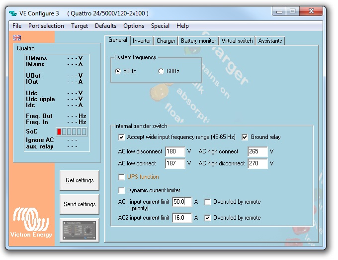

On VEConfigure, there is a tick box "UPS function". This improves transfer speeds, but slows down transferring back to the grid (when it comes back up) and I think there is something else as well that I forgot... if it was important I probably would have remembered. So try enabling the UPS function first. I think it transfers in 16ms with that enabled which really should be good enough for network equipment. I've never had a problem, my Yamaha AV receiver will sometimes click the speakers in and out at most...
Image stolen from elsewhere on the internet... too lazy to start up my virtual host now to make a screenshot :-)
Edit: Oh yes, I remember, with UPS function enabled it's a bit more picky about accepting generator power... that was the other issue I could not remember just now.
