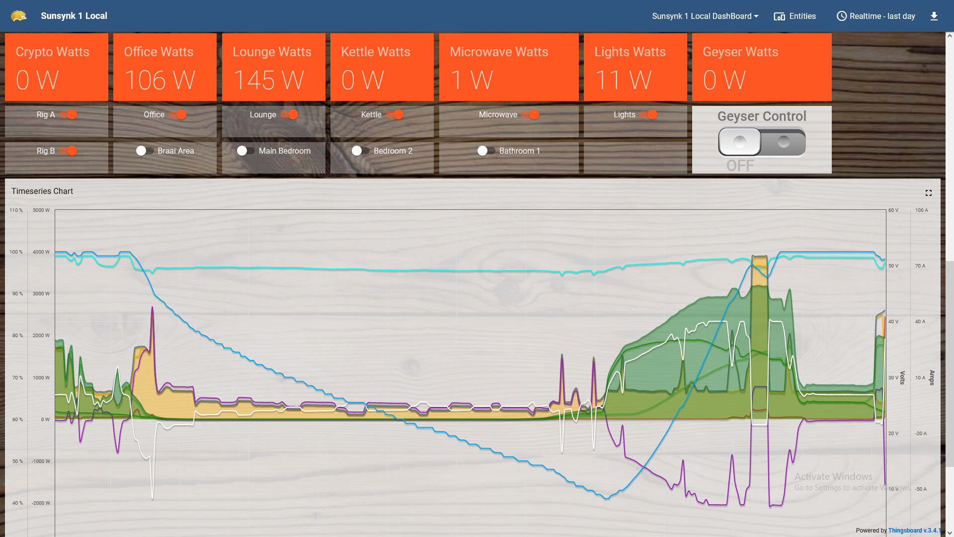

February 27, 20233 yr I have been using one for almost a year now with zero issues on a 3.2kw element. Switches on and off midday every day like clockwork directed from my nodered control via mqtt.
February 27, 20233 yr Author Very impressive charts. Thanks for that confirmation, I ordered 3 and will be flashing them with Tasmota as well. 2 Geysers and one pool pump. Then just waiting for someone to install my solar system. Seems everyone is to busy at the moment.

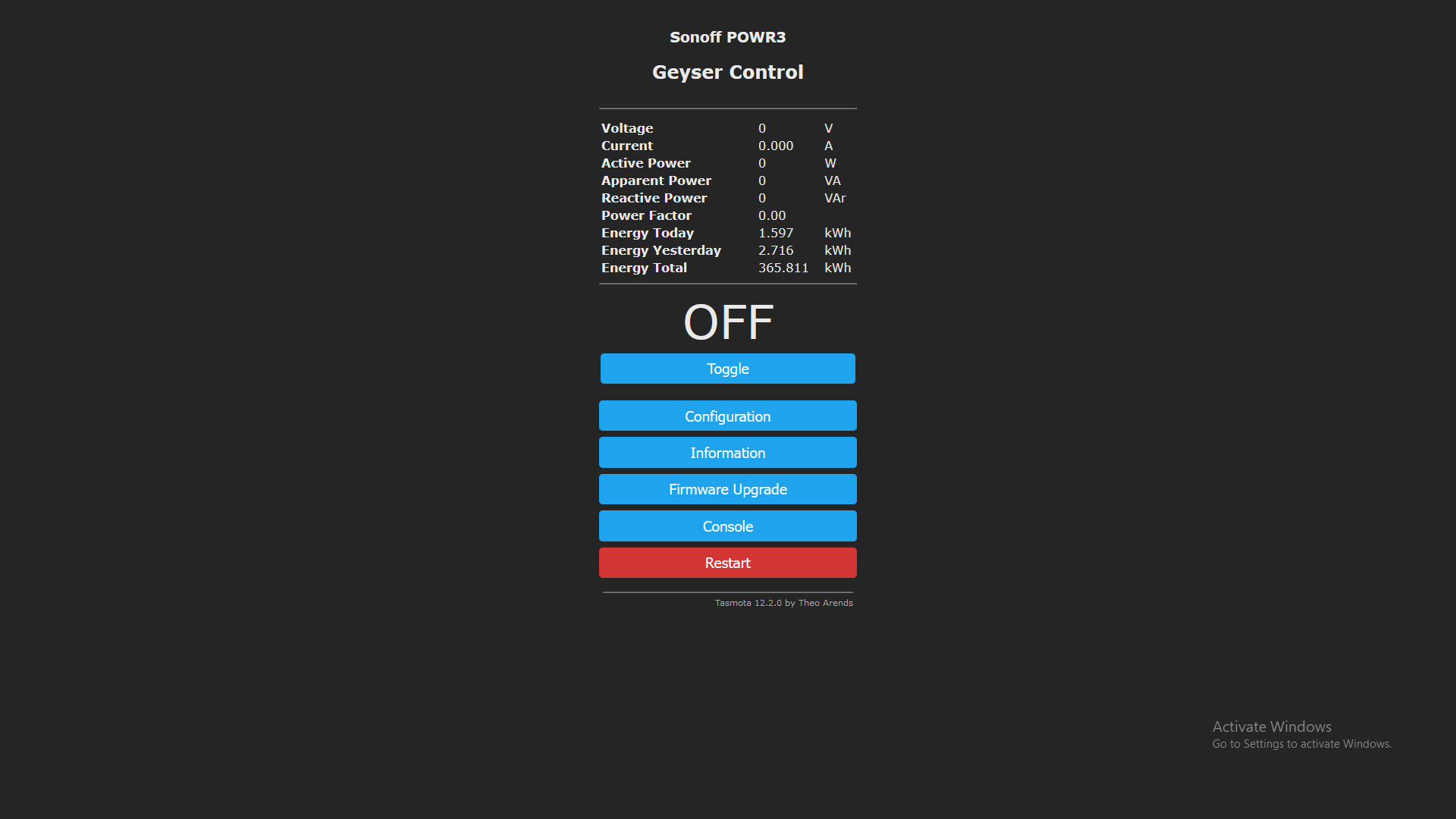

March 10, 20233 yr Author I flashed them with Tasmota, and they are both installed (2 geysers). Works perfectly with my home assistant.

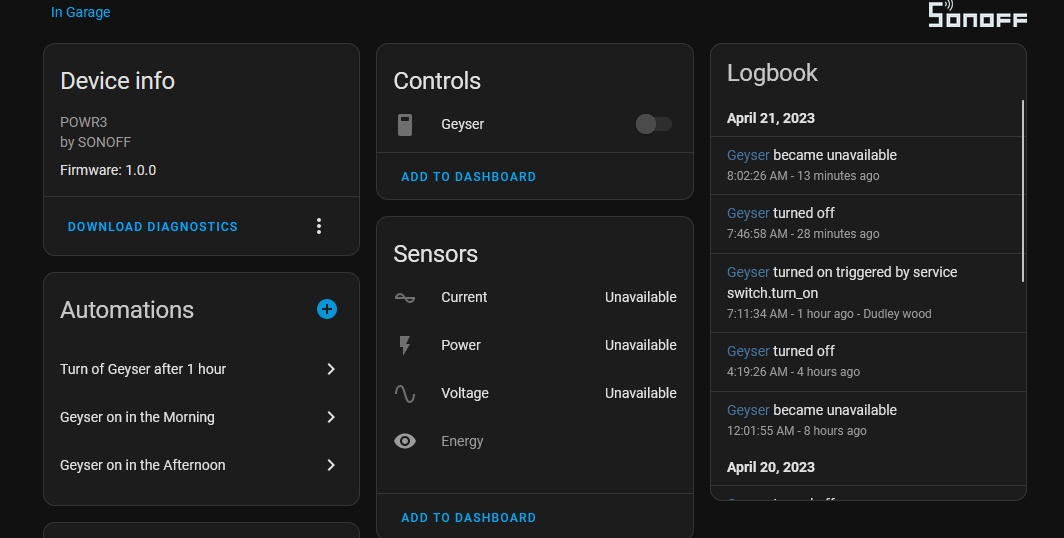

April 21, 20233 yr I also use a POWR3, but instead of flashing it with Tasmota, I already have a Home Assistant with HACS and the Sonoff Plugin. All functionality already present with the advantage of using the eskom se push api where you use the automation to turn on the geyser at strategic times.
