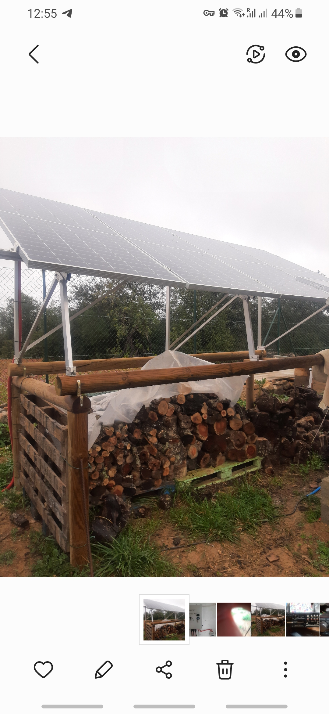

Hi all  I have my solar system set up and itis working perfectly. BUT when it rains I get a small shock from the solar panels the are build on a wood stand as shown in the picture.
I have 12 panels  of 450watts each in total these 4 are the only ones off the ground
Just to make sure is it best to earth these panels So that is does not happen any more or do I Nedd to connect something else
