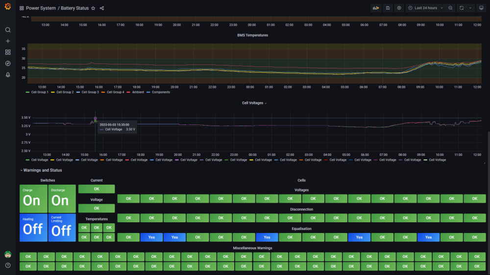

In my case LifePO4  16S I get full charge at 3.53 V, anything above that the BMS goes into equalization mode and stops charging cell above 3,5 V see attached dashboard of the last 24 hours.
