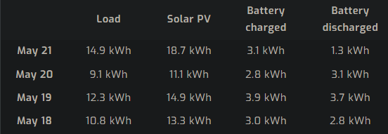

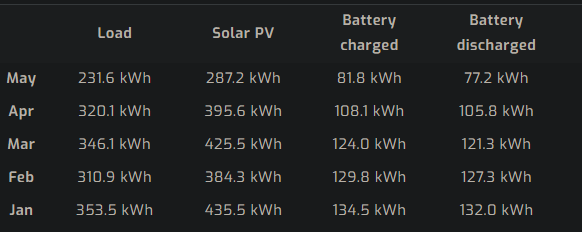

My typical stats, and today was a bit of an exception in terms of usage.
Looks pretty good for 1 battery and 1 inverter.
