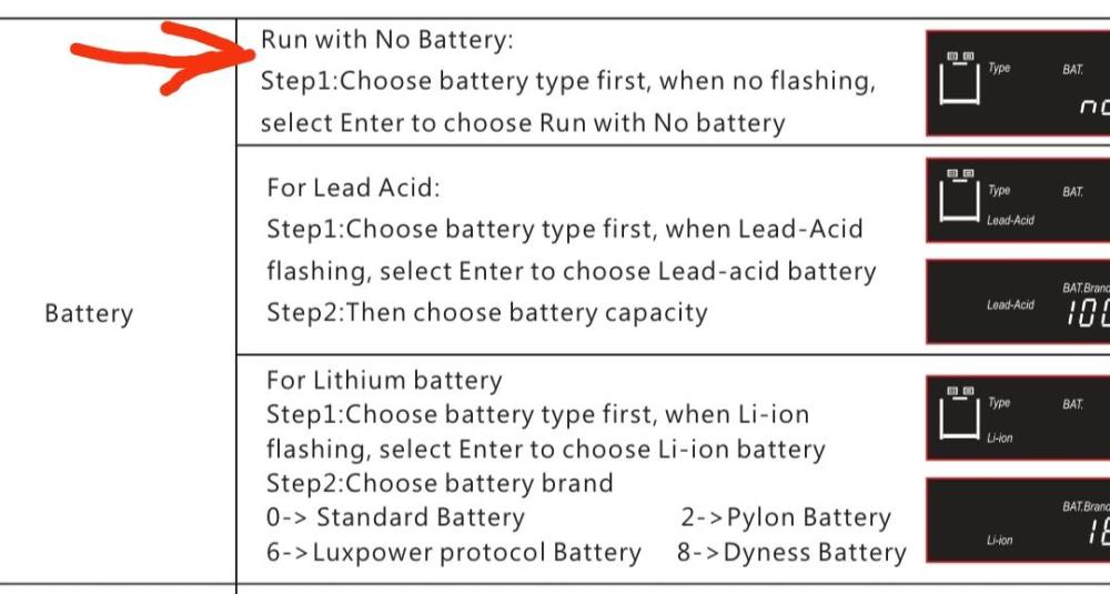

May 15, 20233 yr 48 minutes ago, PsyWulf said: Those 2 are basically comparable,I don't think the SNA can do partial blending though (aka batteryless). The LXP is the luxury model The SNA can work battery less AFAIK. @DeezGP I see no plus having 8 panels into 1 MPPT vs 2x4strings in series in 2xMPPTs. If the 8 need to face different directions the 2xMPPTs are just better. If this is your criteria then go for the Growatt. Then if one day we can export to the munic on good terms then the SNA can do it. Edited May 15, 20233 yr by Scorp007 Added battery picture
