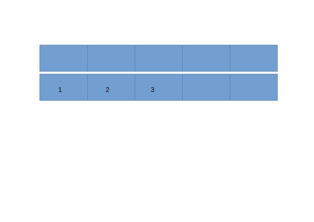

Thunderdolt Posted June 3, 2023 Share Posted June 3, 2023 I am having a structure erected for my 10 x 600W Canadian solar panels connecting to a Sunsynk 8Kw. Facing NNW approx. Panels specs VoC 41.3 , IsC 18.47 MPPT specs 125V - 425V Unfortunately at this time of the year the panels 1,2,3 in my diagram will be shaded for about 45 minutes at midday. Would it be better to put panels 1 to 4 on one string to MPPT 2 and 6 on MPPT 1 or just put all 10 on one string? Or maybe 5 on each MPPT? What would be the better solution? Quote Link to comment Share on other sites More sharing options...
mzezman Posted June 3, 2023 Share Posted June 3, 2023 Go with 5 on each MPPT as the shading will reduce that strings' performance. So if only 1of the MPPT is compromised the other can carry on Quote Link to comment Share on other sites More sharing options...
Kalahari Cruiser Posted June 3, 2023 Share Posted June 3, 2023 7 hours ago, Thunderdolt said: Panels specs VoC 41.3 , IsC 18.47 I also don’t think 10 on one string would be advisable as you’re going to exceed the MPPT max voltage and margin. 10 panels give a Voc of around 500V (I think the spec you quote is the Vmp, not the Voc…). That would effectively limit you to 9 panels on a string unless you split them into the two MPPTs. Quote Link to comment Share on other sites More sharing options...
TimCam Posted June 3, 2023 Share Posted June 3, 2023 These larger Wattage panels do have a lower Voc, and a high Isc, so 10 on a string will be OK, and the 8.8 kW SunSynk can handle the current. As @mzezman suggests try 5 per MPPT, and see how that works for a bit. If you are a DIY, after a week try all 10 on 1 MPPT. Compare the difference and then decide. Another option is to cut down the offending shade. mzezman 1 Quote Link to comment Share on other sites More sharing options...
Kalahari Cruiser Posted June 3, 2023 Share Posted June 3, 2023 Ah right, I did a cursory google and found various sites saying the Voc for that panel is 49.9V ( online vendors as well as solardesigntool.com). But just read the specs off the C Solar website product sheet and indeed, the Voc is quite low and 10 panels in series no problem. TimCam 1 Quote Link to comment Share on other sites More sharing options...
