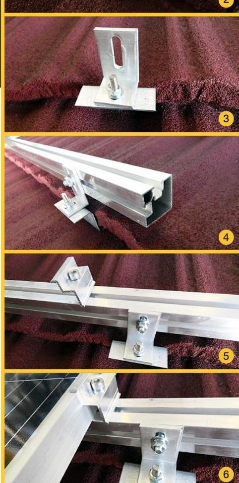

August 26, 20233 yr Noob question in my DIY Solar installation. What's the best solution to mount panels on a Harvey tile roof? Harvey tile offer a mounting bracket but at R100ea and needing to be spaced every meter it's seems quite pricey to mount 10 panels? Are there any other solutions? I don't want to drill the tiles risking a leaking roof later on. Another question is. What happens if hail destroys a panel in 5 years time? My understanding is that your panels need to match 100%. In 5years time you probably not going to find jinko 475w panels anywhere?? Hopefully I'm wrong here

August 30, 20233 yr I also have Harvey tiles and went with the brackets they recommend. I spend some time on the roof and figured that is the best option.

August 30, 20233 yr Author 1 hour ago, McGuywer said: I also have Harvey tiles and went with the brackets they recommend. I spend some time on the roof and figured that is the best option. How many did you use? I see they recommend one every meter but I think one every 1.5m should be ok surely?

September 5, 20232 yr Author On 2023/08/31 at 9:47 AM, McGuywer said: I have not installed the panels. I just had a look at how one would install the panels. I ordered 16 from Takealot and will hopefully install soon. I have not much North facing roof space, so I will see how many panels I can get up. According to OpenSolar, I should be able to get 9/10 panels up but looking at the panels and available space, I doubt that. Got my Harvey tile brackets today. I see in the brochure they use a L bracket to attached the rail to the Harvey tile bracket. Can't you just use the regular p2000 rail and bolt it straight onto the Harvey tile bracket?
September 5, 20232 yr 7 minutes ago, cp69 said: Got my Harvey tile brackets today. I see in the brochure they use a L bracket to attached the rail to the Harvey tile bracket. Can't you just use the regular p2000 rail and bolt it straight onto the Harvey tile bracket? From what I see in the pictures the L bracket allows for adjustment of the rails height and levelling. If you mount rails directly on the brackets, that won’t be possible unless you use some sort of shims.
September 5, 20232 yr Author 2 hours ago, PowerUser said: From what I see in the pictures the L bracket allows for adjustment of the rails height and levelling. If you mount rails directly on the brackets, that won’t be possible unless you use some sort of shims. But if I use the L bracket then I can't use the p2000 rail? Or am I missing something here
September 5, 20232 yr 4 minutes ago, cp69 said: But if I use the L bracket then I can't use the p2000 rail? Or am I missing something here Yes, that’s right.
September 6, 20232 yr Use a rail with L brackets. You can level it better and get better airflow under the panels to help cool them.
September 6, 20232 yr Author 42 minutes ago, Chris_S said: Use a rail with L brackets. You can level it better and get better airflow under the panels to help cool them. Great will do. I will rather do it once and right. Scrapping the p2000 rail idea and will get the L brackets with the 2 channel rail
