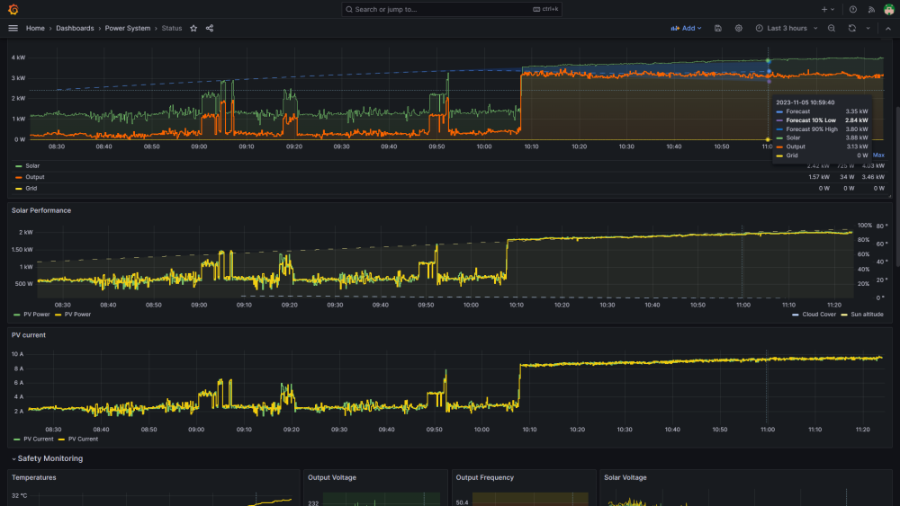

@Bobster. My calculations are pretty accurate, see dashboard of the last 2 years of my system. I'm saving an average of 15 Kw/h per day, I average 21 KW/h home consumption 15 KW/h from PV and 6 KW/h from grid. I think that my ROI will be less than 5 years.
@Bobster. With my custom-made monitoring system, I archive everything possible from my PV, inverters and battery. I've used almost 2 MW from my battery. see dashboard of the last two years of my LBSA 5 KW battery.

In my opinion ROI is also depended on how one runs the system, I for one only use battery for load shedding and occasionally run it for about 6 hours nighttime when my house load is about 1 Kw. I run my system on SUB and only charge the battery from PV. I don't mind using about +_ 5 Kw/h from grid on a daily basis.
My average house daily consumption is +_ 21 KW/h usually 15 KW/h from solar and the remainer from grid.
That amounts to +_ 150 KW/h. a month in my municipality rates on prepaid meter = R350.00.
I have the data to prove it. Last three months.
