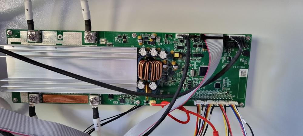

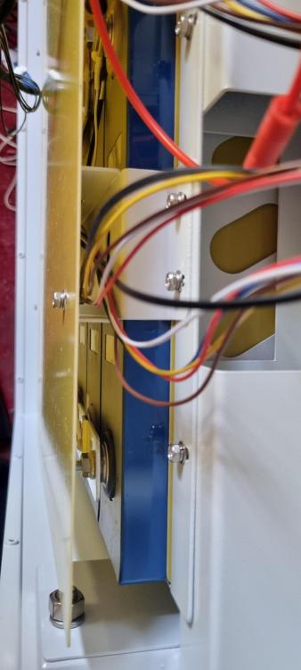

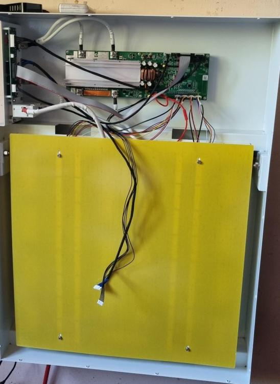

May 1, 20242 yr I decided to open mine up as I`m having no luck with communication on Rs232 or Rs485. Works great otherwise. I was surprised to see, its actually quite well made and neat inside, even has a cover over the battery terminals. The BMS seems to be a Pace 16s150a, board number is SST21-54-3.0
May 2, 20242 yr Hi Tyrel Thanks for the reply! What make battery did you open? Did it have prismatic cells inside?

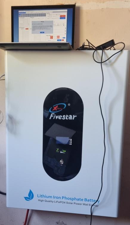

May 3, 20242 yr Hi Oros. Its the Fivestar FS-G01-48200 and yes it has prismatic cells. The BMS resembles the Pace 16s200a, not 150a. I will open again soon and take more pictures. I want to fiddle with the comms on the board as it seems odd to not even have rs232 communication. According to the supplier the bms only communicates with Deye inverters on RS485. I can't get comms on solar assistant with correct cable or on pc.

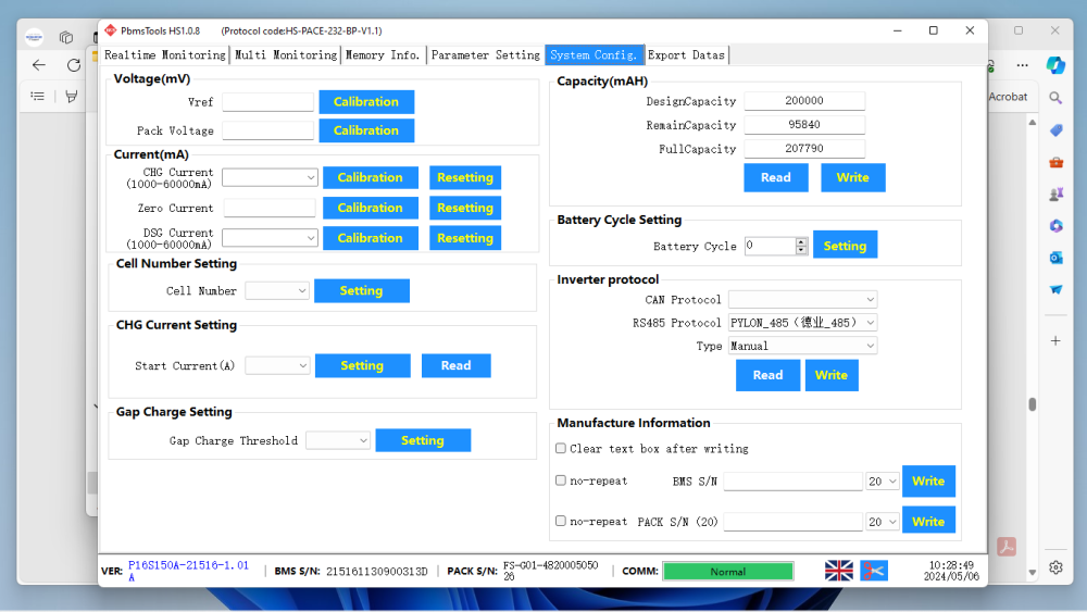

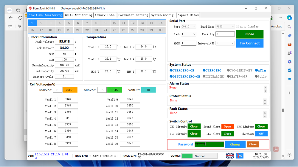

May 6, 20242 yr Success! After plenty of fiddling. Fivestar FS-G01-48200 (Pace 16s150a BMS) RS232 is hit or miss. Have to try multiple times with breaks in between before getting a successful connection using PBMstools HS1.0.8 Inverter protocol is not set, after setting to pylontech I now have BMS coms to my Kodak OGS5.6. The pinouts in the manual are incorrect. BMS coms are on pins 1+2, 7+8. Switch 1 must be on. Hopefully this will help someone else.

May 27, 20242 yr You could try using the Voltronic protocol on the battery. That works with LIb BMS on my Kodak inverter.
May 27, 20242 yr these i was told are using the Felicity protocol and the pinout corresponded to the manual provided. I used the pinout in the manual to connect with pbms Tools. i connected to and used the RJ11 6 pin plug to serial adaptor. problem is finding the pinout or protocol for the new Fivestar inverters
