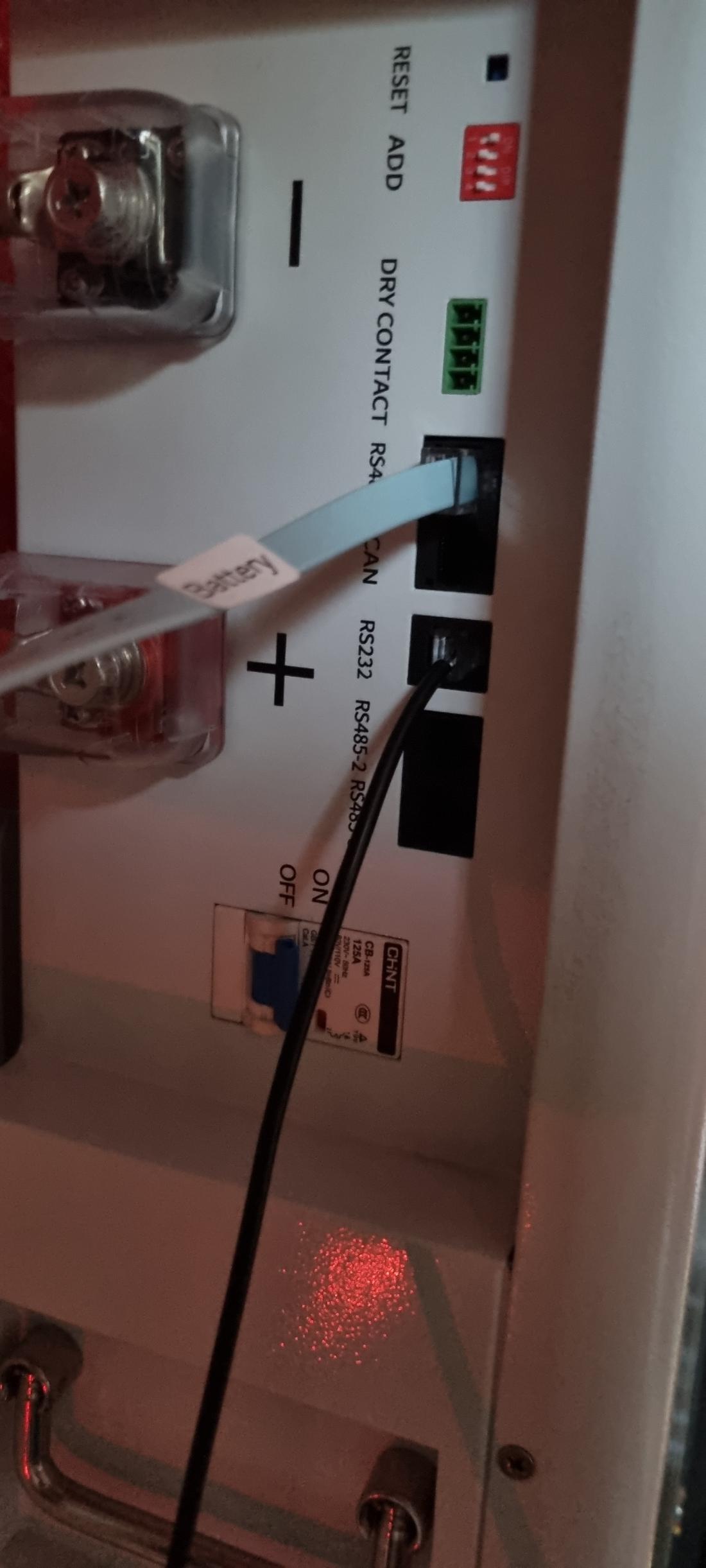

May 28, 20242 yr @Tyrel May I ask that you please post a picture of the comms ports of your battery? Thanks.

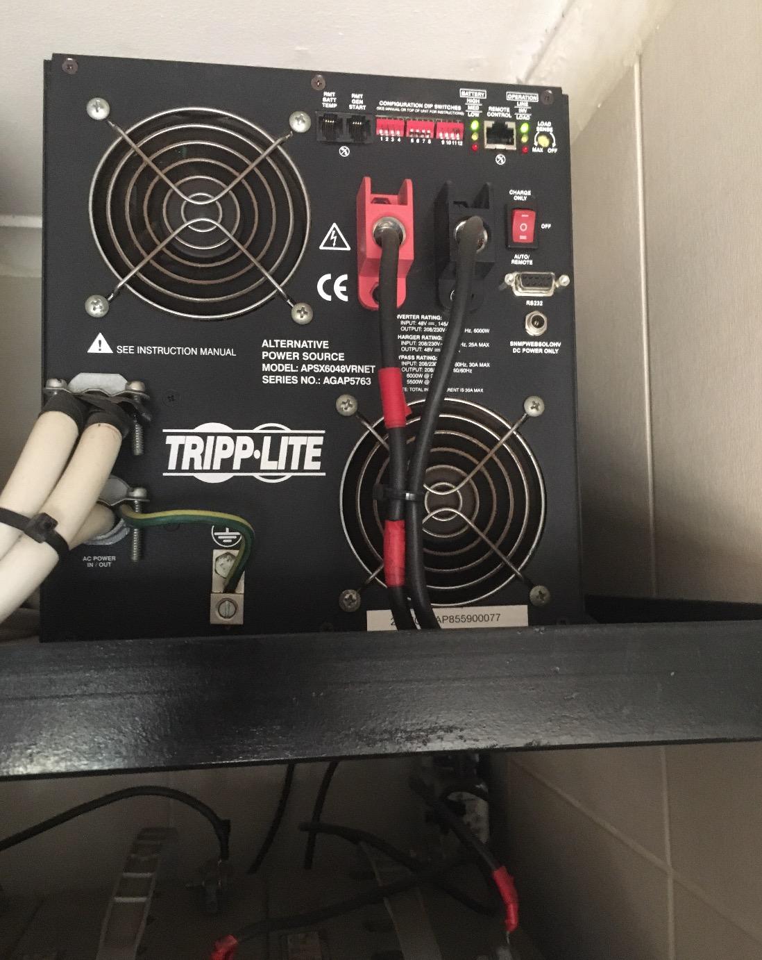

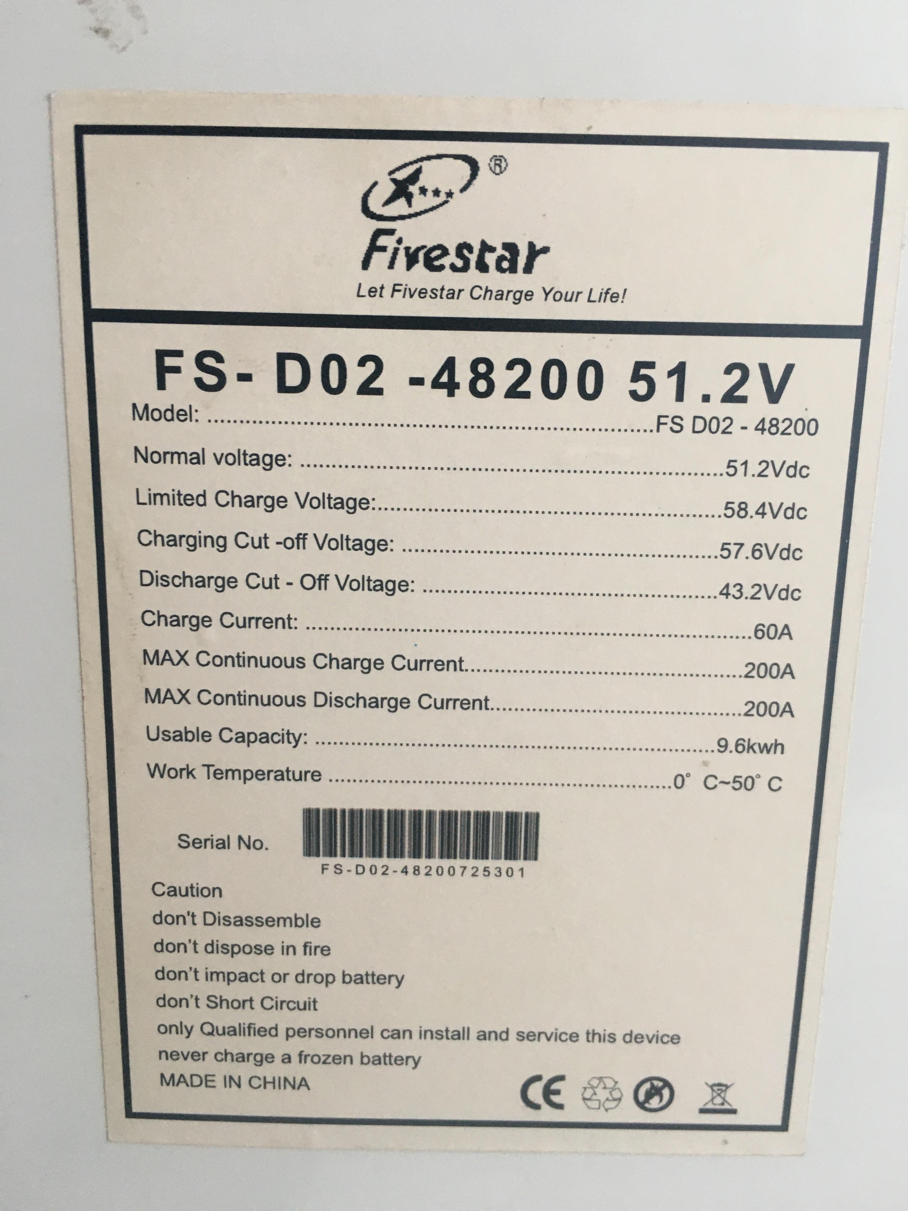

June 24, 20242 yr Greetings Forumites some info would be most appreciated. My neighbour recently purchased this battery and I cannot seem to find any manufacturer information regarding it. It's "coffin shaped", I kid you not, and is very heavy, possibly around the 90Kg mark and the retailer has given a warranty of up to 10years. A warranty is only as good as the reseller still being in business. It's been paired to a 48v Tripp-Lite Inverter which only has dip switches for setting parameters and this has been done.
