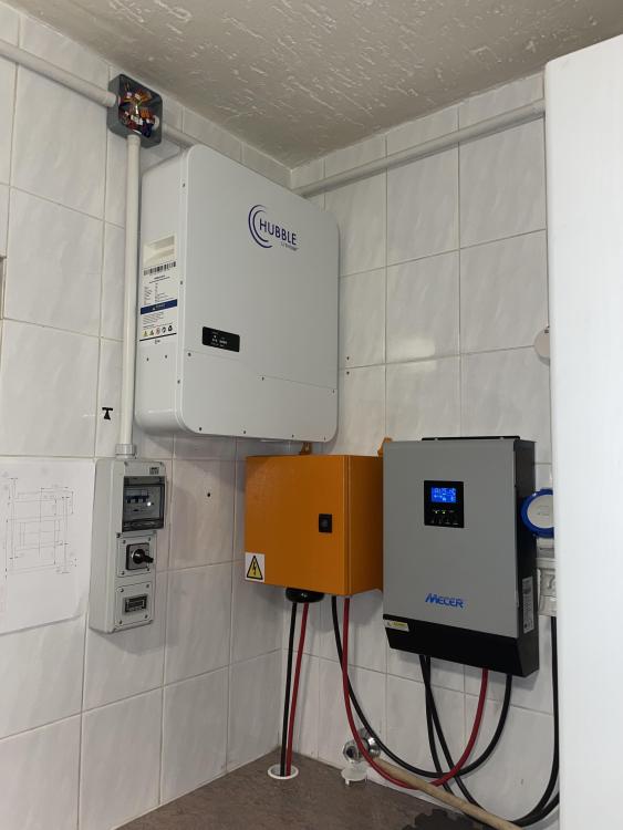

Update
Picked up the Hubble AM5 on 18 December 23.
Its huge and heavy. Took my time to do the install as i had very limited space in the installation area. Lots of measurements and a CAD sketch but it went in like a glove.
Setup the axpert as per hubble settings for this inverter. Bulk and float charge voltages of 55.2V, so a good bit higher than your recomendation @Coulomb
So far its been good, probably have not run more than 200W for longer than an hour yet, but it seems to be performing. Charges are really quick at the recommended 30A charging.
So now to monitor and maintain.
I guess ill need to reduce the float voltage at some point and drain the battery down so i can recharge from SOC 20% back up to 80%.
Hubble recomended cutoff voltage is 48V. This actually suits the inverter better than the AGM batteries I had. On this inverter you cannot set cutoff voltage higher than 48V, which is way too late for a lead acid battery in my view.
Anyway thanks for the help and support guys. Will continue posting as i learn more.
