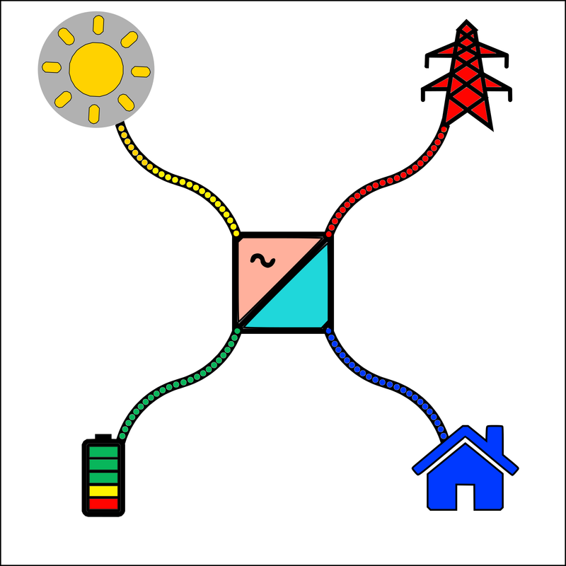

    Deciding on the style look and feel is more complicated than the coding 🤣 Leaning towards a car dashboard type feel with a nice chrome frame. I have also changed the size to A2, my original ide

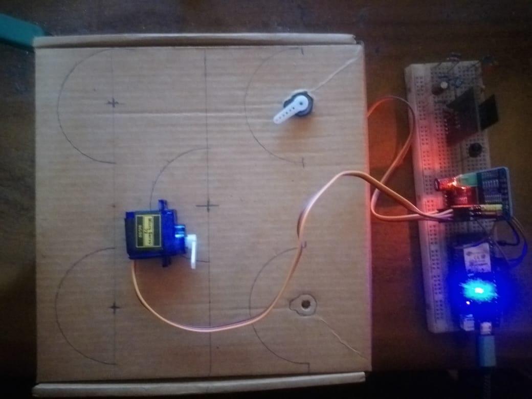

Well it's inside a small cardboard box so it amplifies the sound, but.... it is still pretty quiet.
On my way to go find some of that plastic board to test on, but I am pretty confident the sound will be ok on there too.
The servos move in very tiny increments and only if the values change by more than 5 degrees so overall I think it will be good 🤞
Will have to see once all the servos are hooked up.

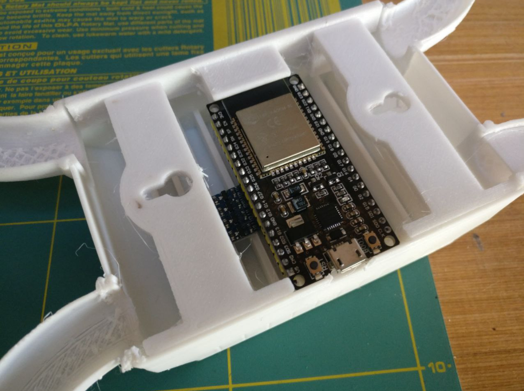

The 'arms' - about 150mm long.  Might need to be a couple of mm wider/deeper to accommodate the 74HC595 chips at the back.
The whole display will be around 500mm x 500mm...
Not sure about the 'inverter' thing in the middle... might just do a model of the Victron Multiplus II, and reproduce the status LEDs from the front panel.

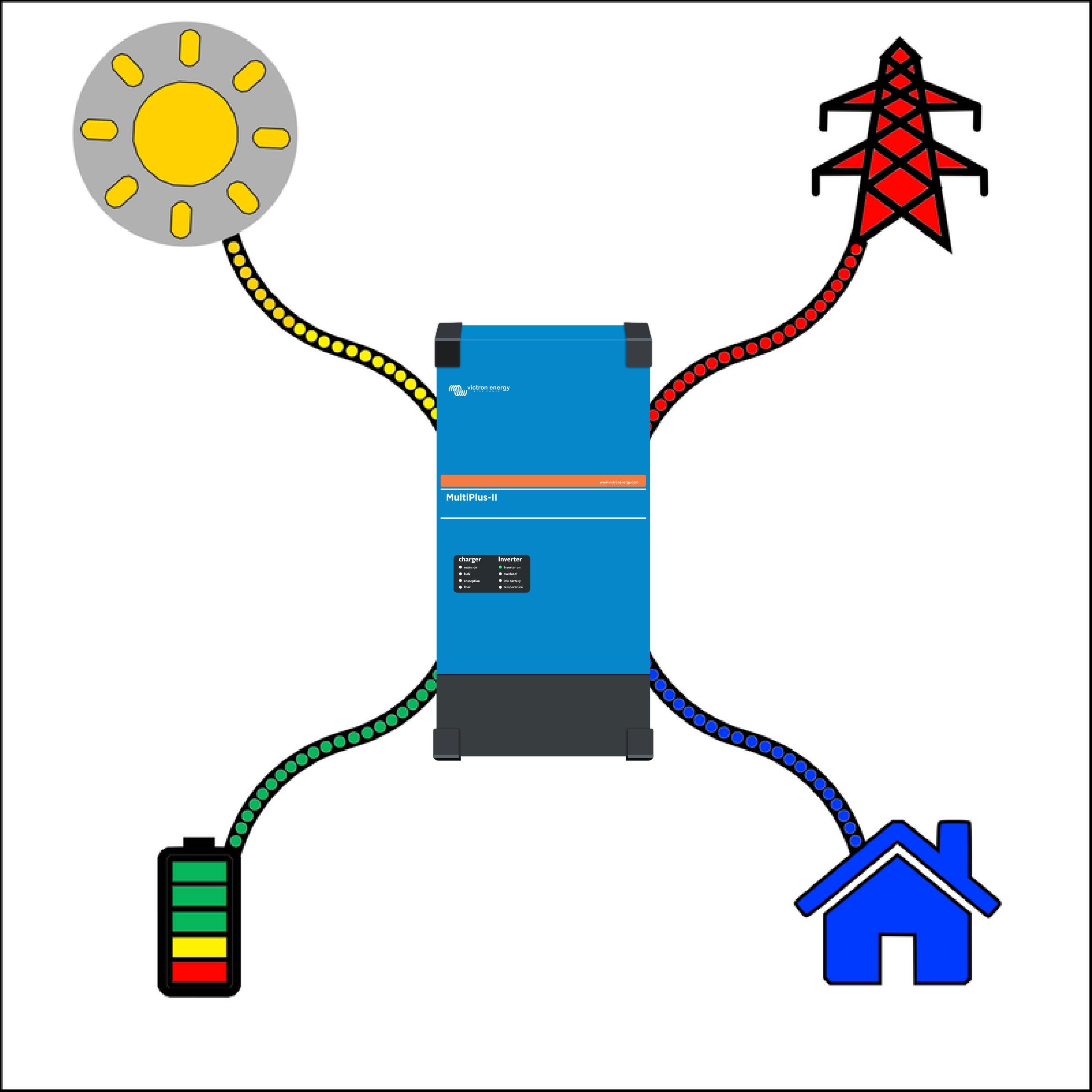

Not sure what Inverter you're using but here's a Vector image you may want use. The PDF format has two pages first page is one you can use to 3-D Print. There's a type of material we use in printing called "Forex" it's a lot more sturdier (3mm) and a lot more robust than Corex over the course of time... for your consideration. 😁
System Display.pdf
Edited by Moffat
Cheers for that, Moffat. 🙂
We use a Victron Multiplus II here, so I'm roughly modelling that with white PETG and lighting it up from inside...
There should still be room to get the ESP32 in there, too - if I go steady with the hot glue, that is. 😁

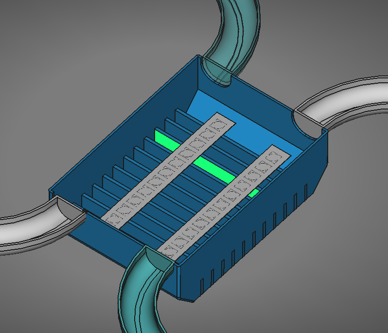

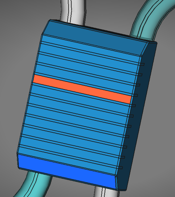

I was considering faithfully reproducing the Multiplus status LEDs, but realised that they're not particularly informative or useful.  Using the whole 'inverter' on the new panel as a 12 segment indication of inverter load will be much more useful.  I'm thinking of having blue up to nearly the limit, then the Victron trademark 'orange stripe', then everything turning an ominous red when the inverter limit is exceeded and we're drawing grid power.

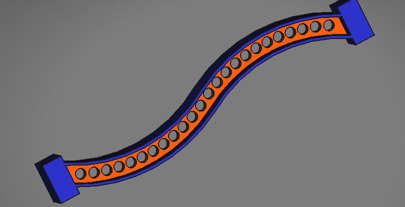

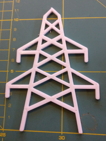

Anyway... I made a pylon (or rather, the front of it):
It sits on top of another one that is slightly thicker, but also has a 0.5mm backing 'membrane' printed the size and shape of the middle bit (i.e. without the arms) to diffuse the (6) LEDs.  The lower bit looks wrong (it would be unstable), but I had to make room for the light pipe thingy to attach in at the bottom.  The printer's just chugging one of those out now. 🙂

I have also changed the size to A2, my original idea with 100cmX70cm was just way too big.
This is great work. Is the Solar PV in text mirrored for a reason 😀😀🤔
This is just my scribbling so I can figure out a nice layout, will be doing all new hi res images with the correct scales and numbering before taking it to the printers 🙃

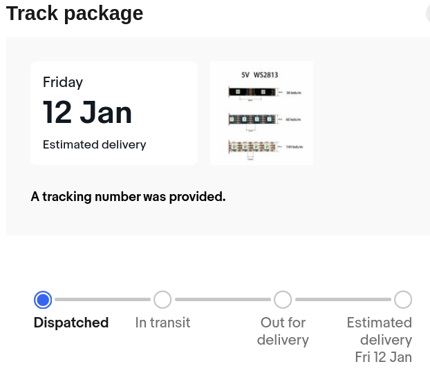

My LEDs are apparently in the UK now... "5 Jan 2024: Customs Clearance-London Heathrow, Scanned-Scanned At Dispatch Hub".
Nice they should be with you soon then :)

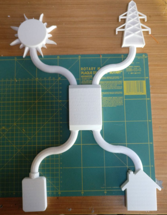

Here's the whole thing so far...
I might have to re-do the sun, though.  It's supposed to be sized so that the 60-LED-per-metre strip lines up with the 'rays' inside, but I suspect it won't and needs to be about 15mm bigger diameter...  I tried it with the 30-per-metre, expecting it to be lining up with every other ray, but it's miles out. 😢
Still, what's not to like about a bigger sun?  Making the 'rays' a bit bigger would certainly print a lot better, too. 🙂
