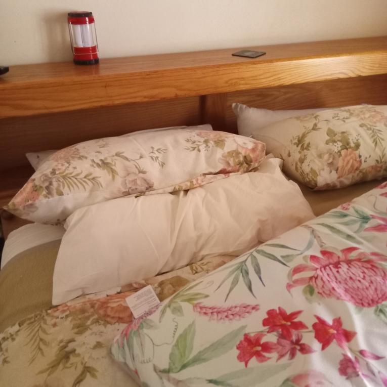

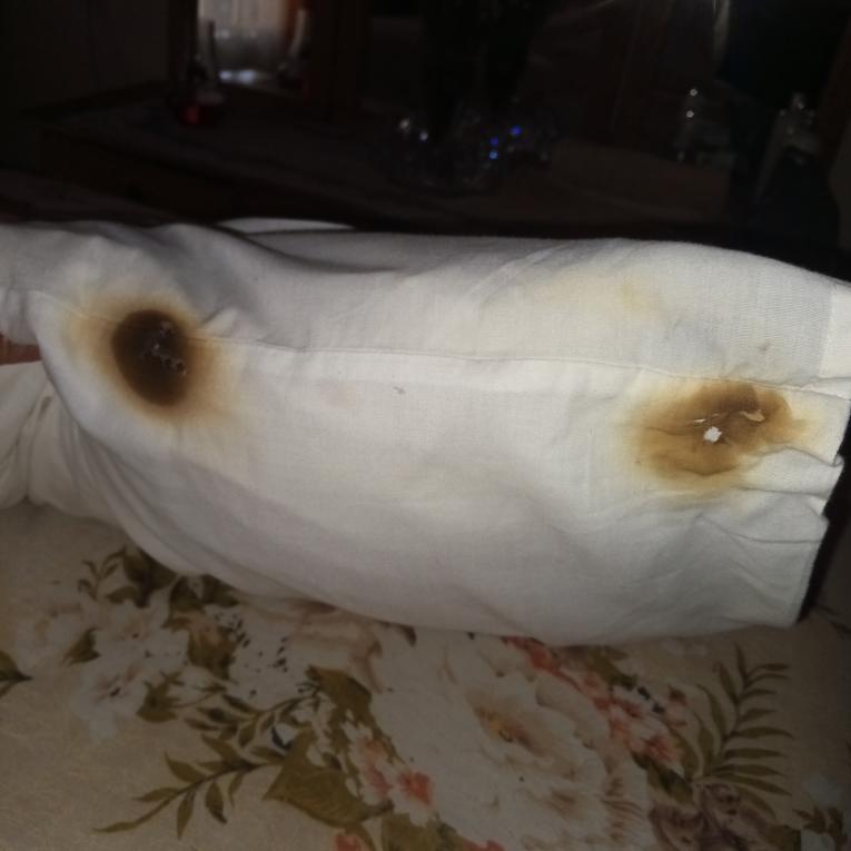

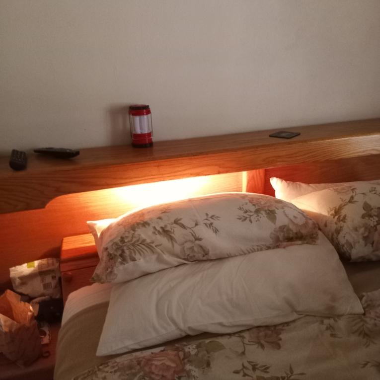

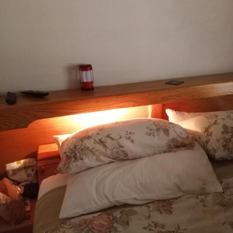

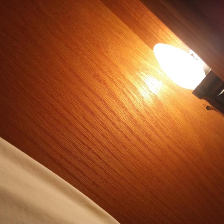

I was called out by a client in Cpt for a burning smell only at night in his main bedroom. As he explained it smells like something is burning. Indeed this is what i found. Old type Tungsten screw type bulbs in the headboard recess both sides of the bed. By the way these Tungsten filament bulbs is now officially discontinued and are not allowed to be sold in SA. Pictures below that could have had serious consequences for the house owner. As the pillows moves around when persons lying on the bed pressing against the bulbs that could have ignited the pillow.

Just to reiterate!! More than 90% of the energy from incandescent bulbs is lost as heat. About 80% of the energy from CFL bulbs is lost as heat. LED bulbs give off almost no heat. I changed the 2 bulbs to 5w E14 LED Warm white(3,000k). No heat whatsoever.
