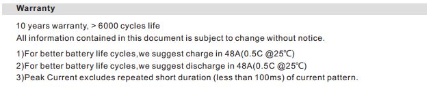

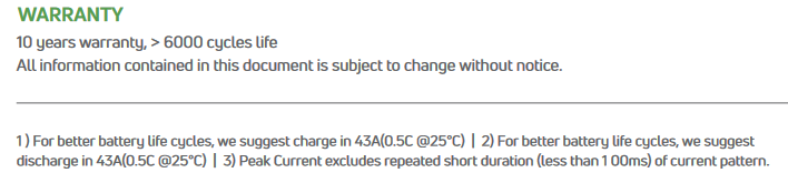

July 30, 20242 yr 1 hour ago, Bruce Gu said: Tests show that using the batteries at high power for short times doesn’t significantly shorten their life What will using the batteries at high power for long periods do, though? It is fine to say that the batteries can go to 1.5C discharge and then add the phrase "for short times" but can it run at or close to 1.5C discharge for longer periods? Where is the sweet spot? If the manufacturer is honest it will indicate where that sweet spot sits and if it is at 1C or even 0.5C then it would be hard to convince me that anything more for longer periods is a good idea. Greenrich UP5000 manual says: Greenrich UP5000 brochure says: They don't agree whether it be 48A or 43A but even if there is a reason for that discrepency they still both say "For better battery life cycles, we suggest charge/discharge at 4xA (0.5C @25°C)". Does this "better battery life cycles" mean that I will get much, much more than 6000 cycles if I use it only at 0.5C for long periods and close to 6000 cycles if I use it at 1.5C for long periods or does it mean I will only get more than 6000 cycles if I use it only at 0.5C for long periods and much less than 6000 cycles if I use it at 1.5C for long periods? Devil in the details? On 2024/07/24 at 2:48 PM, Bruce Gu said: We have recently become aware of claims that Greenrich battery, particularly our signature 1.5C battery, are unsuitable and unfit for the residential solar energy storage market. I own 2 x Greenrich UP5000 on two installations and I like them. I charge at 20A and have my inverter set to 70A discharge which I never reach. I am not an expert on batteries but to my limited knowledge they are good. I am sure most here will not say they are unsuitable. @JayMardern also said so. 1 hour ago, Bruce Gu said: Greenrich batteries give you reliable performance in all kinds of power situations I agree but does that reliable performance give me >6000 cycles at 1.5C the same as >6000 at 0.5C? I see performance here as delivering the required power, not lifespan. So if you want to refute claims made by some out there that Greenrich Batteries are unsuitable then I stand by you. If you want to claim that Greenrich batteries can discharge at 1.5C for short periods of time, sure go ahead. But I do not think discharging/charging at 1.5C for longer periods is a good idea. You can reach 280km/h with the Merc but you may possibly end up wrecking your car or killing another motorist or pedestrian. Edited July 30, 20242 yr by TheMac
