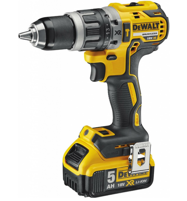

Here's an excellent reason to get a generator. When you arrive on the farm with a pile of solar panels and mounting brackets and wiring to be installed, how are you going to drill a hole in anything? :P
You are a good salesman! :D
I mounted 72 panels just using 2x Cordless Drill and 6 battery packs. True is, that I have 230V outlet in my car, so the occasional charging is not a problem for me...
36 minutes ago, Youda said:
Cordless Drill
Yup, the last frame I put up I pretty much did using only a drill and some hand tools. Of course my cordless unit has long since grown a bad battery and as a result I used the 15-year old green Bosch drill (aka the DIY one... not the nice blue professional one). But at least in theory I COULD have done the whole thing using only a cordless drill.
You could also just hire a cheap petrol generator for the duration of the install... if you really wanted to be all nit-picky and prove that it can be done. But the general point has been made: You're going to need one at some point.
