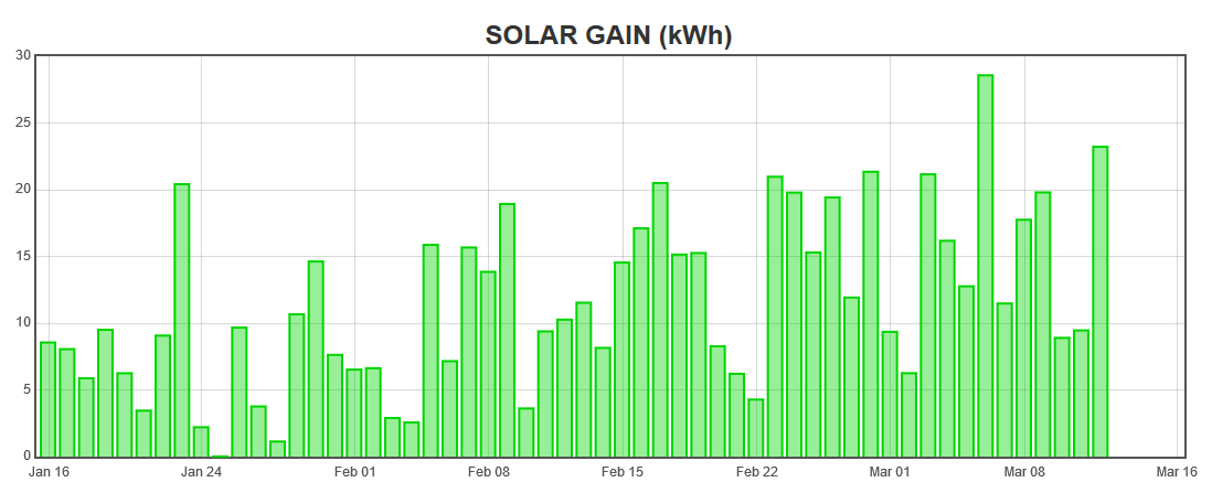

Around 20kWh.

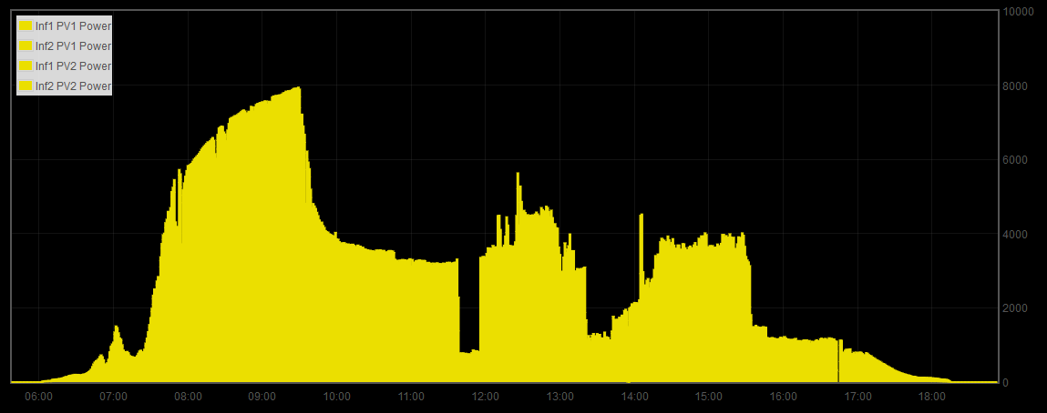

But on the active day, it can be MUCH more easily. So it's good to have a slightly bigger batteries or to have a diesel genset as a backup, if needed.
The thing is, that I drastically oversized my PV system, but I'm not feeding into the grid, too. So, when I have no use for the solar power I simply "let it stay on the roof". It's clearly visible on the chart below: The battery was full at 10am, and since there were no major AC loads, the generation dropped.
Speaking of monitoring, I would say that for the wife it's okay to have a battery monitor (or a tablet on the wall) with just one number and some bargraph - Battery SoC.
For you, it's better to have something more sophisticated - ICC or some homebrew monitoring at least:
(Excuse the °C and Btu/h, please - there's a long story behind, why I used these symbols instead of %SoC and Ah...)

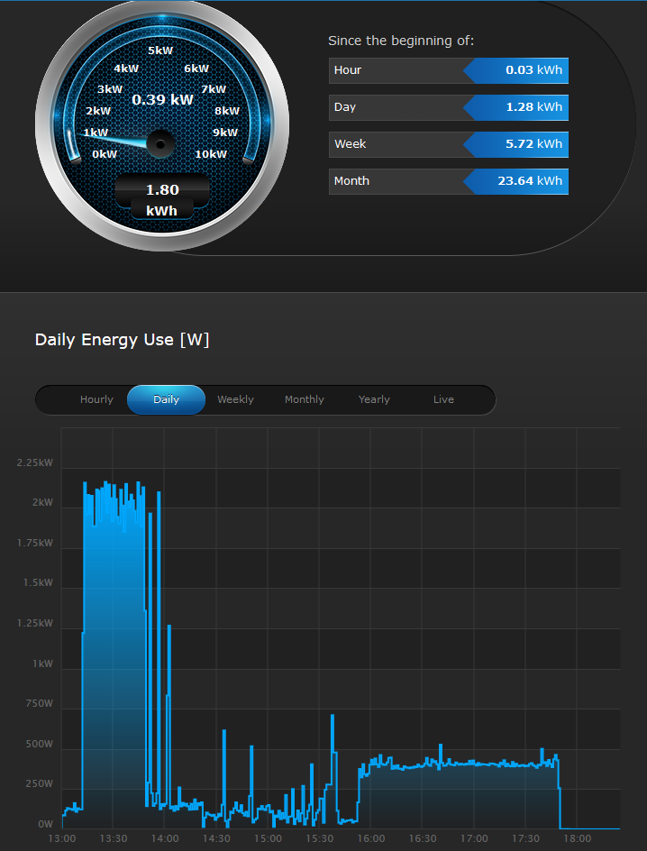

I'm using the washing machine that's combined with the heatpump tumble dryer (AEG). Here's the sample of the consumption. For one batch of laundering+drying it's cca 2kWh:
You can easily do 2 or 3 batches of laundry on one day. So it's good to size for that, especially if you plan to go fully offgrid.

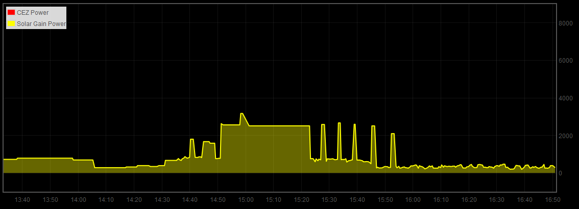

And this is electric owen's consumption profile:
- For the first hour of operation, it runs at 2kW for 30 minutes.
- Then there are just short 1 minute spikes.
- 1st hour uses roughly 1.2kWh of energy, but in the following hours the consumption is "almost nothing"
Therefore, it's good to prepare a few baking batches and do them all in a row.

You are right! These are the parts of the laundry cycle:
There was an option to use the hot water from the geyser, but my washing machine has just one water inlet - for the cold water. And as far as I know, there are some parts of the cycle where it needs a bit colder water - rinsing for example. Also, with wool sweaters, you have to wash them using cold water only, otherwise they shrink (The cost of this experince was R3000 that I payed for a brand new Tommy Hilfiger....oh my!)
But I know a couple of guys who installed a thermostatic valve in front of the water inlet, so it's mixing water from the geyser with the cold water. Then, the heater has not to work for so long and the laundry is done okay too.
