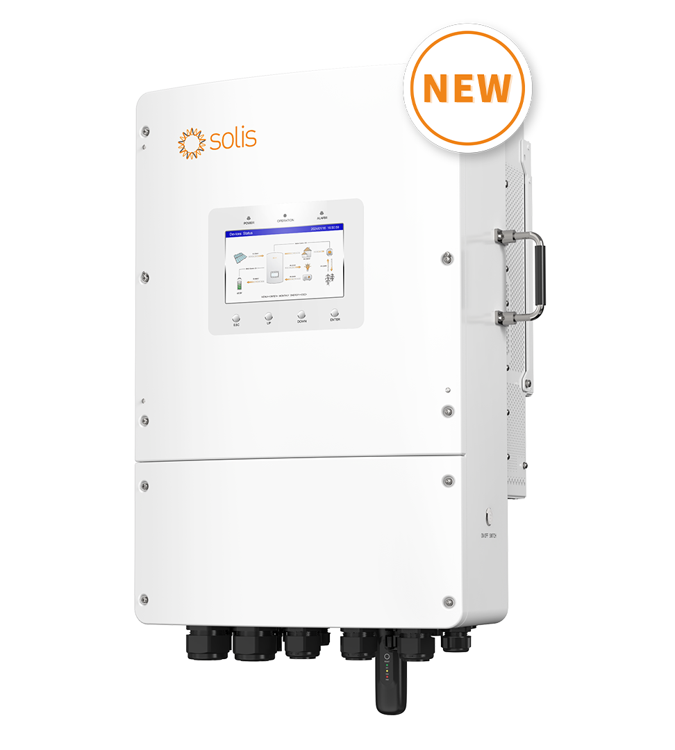

Currently have Voltronic Infini 10KW 3P Hybrid inverter. Looking to upgrade, mainly due to fan noise and Lithium battery support. Deciding between Solis 12KW vs Deye 12KW. I see that Deye has a longer history on this forum, however, Solis is considerably cheaper and although its a new model, the company seems to have decent reputation. Which inverter would you guys recommend, in terms of quality, reliability and longer lifespan?
Solis S6 model Link

Solis 12KW vs Deye 12KW,I compared the parameters of both, and there are almost no differences in the important ones. The only difference is that Solis has a higher charging and discharging current than Deye. I believe both are good options and excellent brands.

The Solis spec sheet indicates noise levels below 65dB(A), while Deye indicates below 55dB. [The current linked Deye shows the un-weighted dB rating, while the previous Deye indicates the A-weighted noise levels as up to 55dB(A)]. Reading between the lines, it seems to come down to Solis having more robust cooling that operates up to 4000m altitude, while Deye is only rated to 3000m altitude.
Don't have any personal experience of either, but since it seems to matter to you, I'd try to personally listen to each in action and compare before buying.
