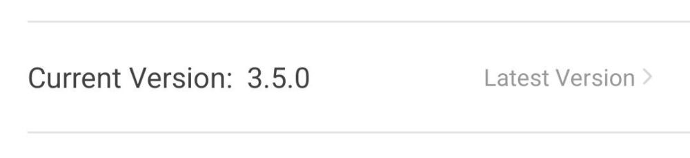

March 17, 20251 yr No firmware listed for my one yet. Still on 3.5.0, will wait and see but can I ask that once its published can someone just give feedback if this resolved their issue. Will be highly appreciated.Also just realized I have 49 other devices that have firmware updates pending, guess I know what I'm doing tonight 😅
