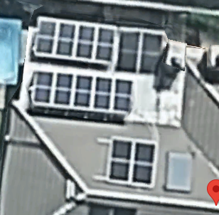

Right, it's a flat roof and it's two rows of panels. The first row is too close to the second and causes shading as shown.
The purple line indicated the area of shading.
What is the angle at the moment? Looks close to 40 degrees to me.

Had a similar problem at my parents house
Front row was casting a shadow on the 2nd road, the solution was to lower the angle massively and slide the panels forward.
As you can see in the above, it over hangs the IBR roof slightly which isnt ideal, and at the lower angle, there is some lost efficiency, however, this is made up by the considerable increase in performance from not having shading on the rear 5 panels.
