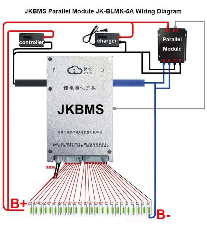

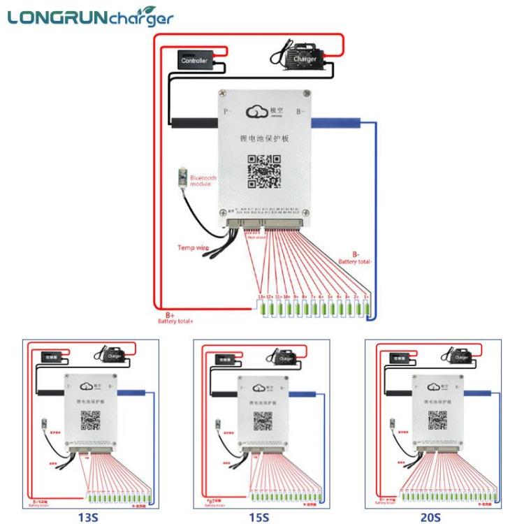

im new to this bms n cant find instructions in English. Dont want to see magic smoke again. So step by step
a- B- to battery main negative
b-B1-b16 to cells' positive.
c-B+(leftest balance cable) to battery main positive
d-P- n B+ terminal to Load/charger
e-Apply charge voltage to wake up BMS
is this correct? thnx for help.

both B- including balancing B- wire to main negative
B1 onward to cells positive terminals (from the most negative cell onward), and B+ will join the last actually connected B-lead (probably B16 in a 16S battery)
P- is power source/load negative connection and + connection is to battery's positive end for source/load
If you don't have the switch, then a voltage of around 5V between P- and B- should wake up the BMS

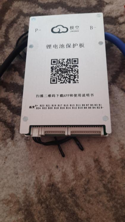

Just to clarify. This 5-9V supply the + goes to B- and - to P-. This should give a beep and all should work fine. Only briefly touch the 2 leads from this supply.
I have tried using 3 different multimeters for the wake up and neither could do the trick. The above works every time.
