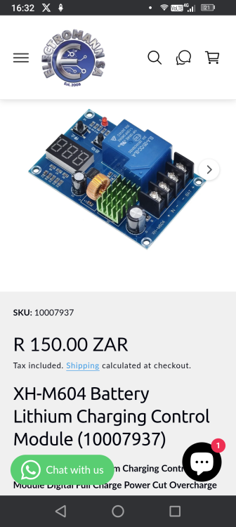

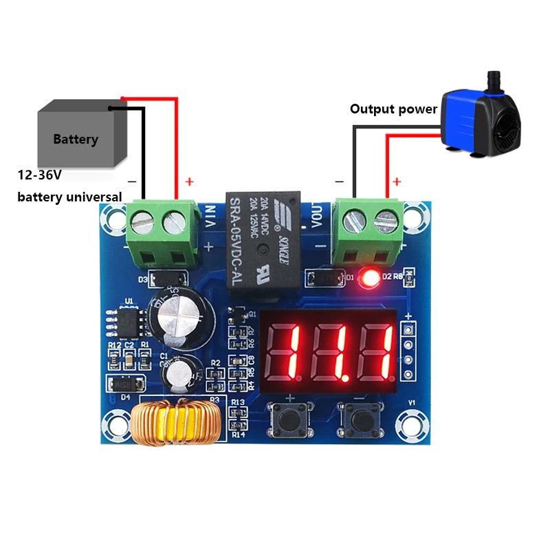

Contact Electromann SA and ask them to modify this board to accommodate 48v battery. Then use a DC relay on the output to switch the geyser off at settable threshold. I have used these curcuit boards on battery chargers for vechile starter batteries to automatically top them up if vechiles are stationary for long periods.
They cost 80 bucks and work well.

Can just add a simple buck/boost converter in between without having to modify the board. The converters are super cheap also. And he just scales accordingly.

Due to this 36V limitation I suggested the M602 model that switches 230V AC that one can then drive a beefier relay to the geyser.
