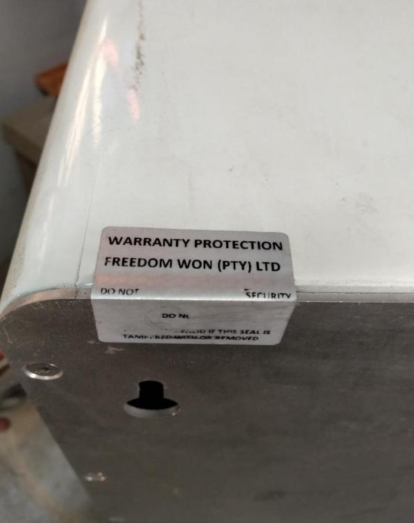

Good day guys, I haven't posted something for a while and really haven't had the time. A very interesting problem arose on my FreedomWon 10/8 & due to the sheer frustration of trying to get support I made a decision to get intrusive with the unit & I voided the warranty. More on the warranty a little later and in general I hope that this thread opens up a very worthwhile conversation on warranties and what are they really worth. Even more interesting is the South Africa Battery assemblers as I call them. Let's face it, the raw Lithium is processed in China and made into prismatic cells and then shipped away to our shores as either an assembled battery unit or finds itself on the assembly line here in SA via FreedomWon factory or other well known SA battery manufacturers. The Local guys here then have a factory to a build those prismatic cells into a production unit & pair it with a BMS and then sell this finished product.

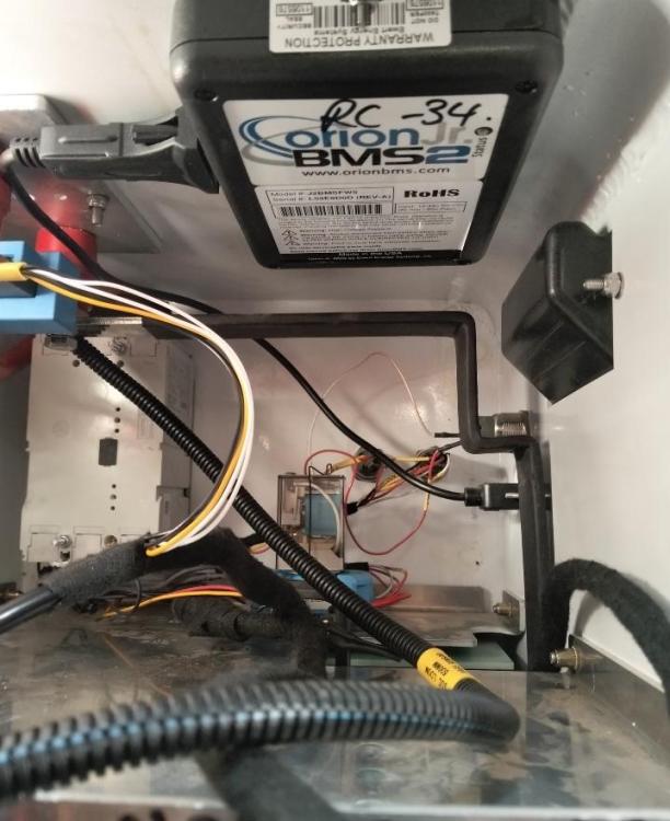

The Orion is in a different class to any other BMS out there. I have worked on multiple other BMSs. That BMS is made in the USA and it's a very polished specimen in terms of hardware and software. It's even used in the HV batteries to power up the Toyota Prius EV. Btw I'm not sure it's an OEM of the Prius but I do see documentation to supports it's applied use.

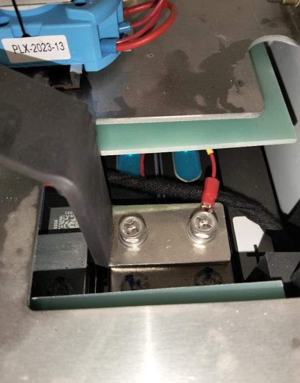

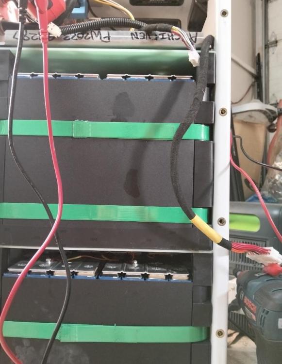

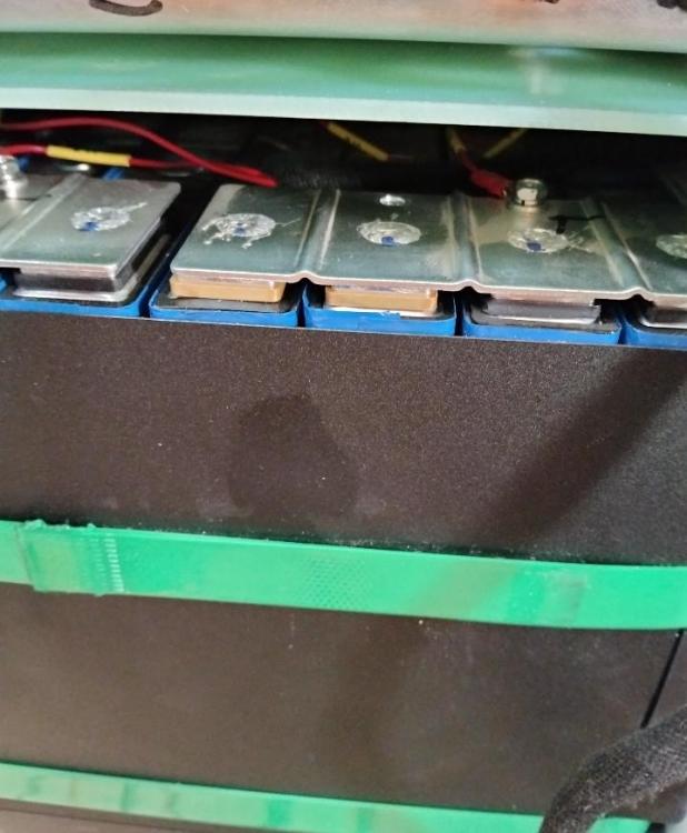

My battery got very ill due to my home being completely off-grid and not reaching 100% regularly to float. The first issue that I had was that Cell 1 had a massively weird difference in internal resistance to the others. Then when you charge it the Cell would peak crazily fast and during the discharge the opposite would happen. I logged a ticket and got some remote support but the particular service tech was adjusting software to fix what was very likely to me a physical hardware fault. You can fix hardware problems with software. You can maybe mask the problem but you can't fix it.
I then left it for a week or so & FW basically tried to close the ticket saying it was fixed. I knew the only issue that can arise as these symptoms are a loose cell sensing cable and the cell was not in balance.
The hardware of the 10/8 is on another planet quality wise. FW package this battery to a high level of quality. It's in a powder coated high gloss 3mm metal enclosure and the cells are very well protected inside a plastic types of rigid case with insulation covers. I wanted to remove the entire unit to get at the offensive cell. It's probably possible but given the welded topology and the fact they actually use 2 X 100ah cells laser welded with aluminium studs made that proposition almost impossible to deassemble the entire unit. So all I had to play with was the Harness or 16 cells and a slow charger...

Very happy to report that my invasive balancing and getting my 10/8 back into a positive direction has bore some fruits...Was a bad case of not reaching 100% and giving the poor battery a chance to top balance and level things out.
She is now producing what I expect and I'm happy that it wasn't anything worse than I thought. Sometimes there is a good ending...the delta to Lowest and highest cell been reducing for a few days and cycles.
