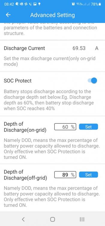

I have been running this setup for 1 year now, I have tried the following modes :

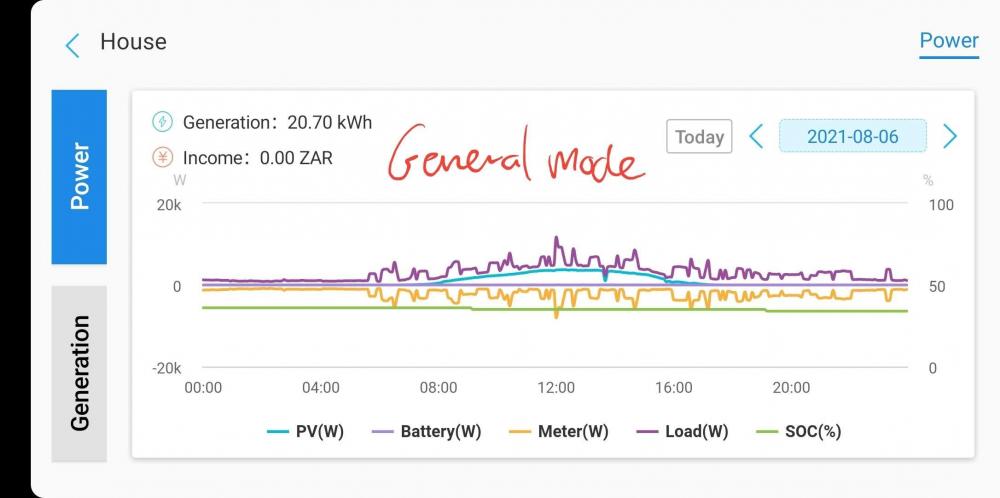

1) General Mode : My Batteries never charge, it might be that my load is too high so not enough PV to charge the batteries? see attached Screenshots,
2) Back-up Mode : Works fine but i feel like i am not using the System to full Capacity. (I have been using this mode 90% of the time)

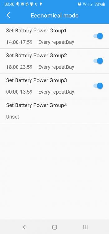

3) Eco Mode : So i have changed to Eco Mode a few days ago,

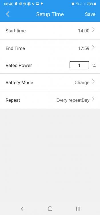

Group 1 Set the Charge time from 14:00 to 17:59 @ 1% Rated Power, (i will change this as the batteries Charge in about 2 hours)

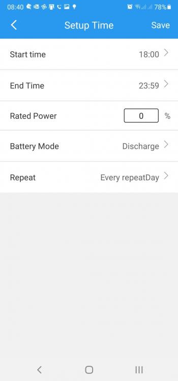

Group 2 : Set the Discharge time from 18:00 to 23:59 @ 0% Rated Power

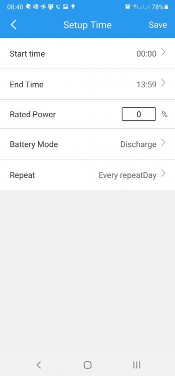

Group 3 : Set the Discharge time from 00:00 to 13:59 @ 0% Rated Power
Export Power Limit on - Set to 100w
DOD on-Grid - 60%
DOD off-Grid - 89%
Now based on the ECO Mode, the batteries charge full with Solar from 14:00 to 16:00, then from 18:00 it starts discharging, at this time my load is generally low but for some reason the load jumps just to discharge the batteries, so by 19:30 my batteries are down to 40%, (see attached Screenshot) Same thing happens everyday. Then once the batteries are discharged the load drops back down.
Are my settings wrong? or is there something wrong with the Inverter?
Can someone please advise the best setup to get the most out of the system? I attached Screenshots of my current Setup.
Thanking you in Advance.

Hi @Rehaan your first screen shot shows nearly 21kw/h generation for the day BUT PV is always less than load, so you used more than was generated. Also because the PV is always less than load, there is never any PV available to charge the batteries. So the battery just sits at 40% SOC as long as there is grid.
So first thing to figure out is where is all the juice going? As long as you consume more than you generate this situation will remain - the battery will stay at the 40% SOC you have reserved and any PV you do generate will be used to service the load.

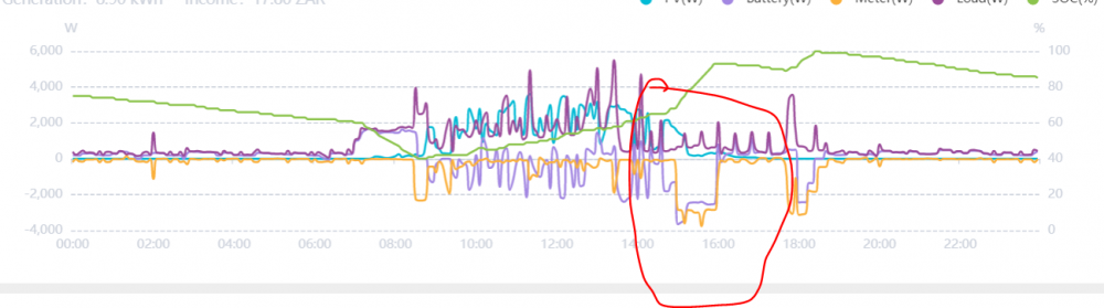

Look at this trace from my system. You can see the rule in economy mode kicking in at 2pm. PV is low, SOC is increasing and we see a big bump in the yellow grid trace - that's the grid power that is being used to charge the battery. We don't see that downward bump in your graph. Your SOC goes up, there is no increase shown in PV nor in grid, so where is the battery getting power from? Strange.

Hi Rehaan, agree with Bobster and Tinuva that there is something really odd with your system, Not to sure what your loads are like but your bill is extremely high, especially with your spec system.
Looking at the below, It almost looks like your load "follows" or "ride on top" your PV output, i.e. as the PV output increases, the load below seems to increase, also the imported current (yellow) does not seem to be affected by the P.V.
The two load areas marked with the red circles seems to nicely mirror the PV output.
This may also have something to do with your load "jumping" to discharge the battery.

13 hours ago, Rehaan said:
@WeNotGood @Tinuva Ok so at 10pm one evening i switched on my 36000BTU aircon and the load did not increase on the PV master or SEMS app. My electric geyser is always switched on (No Timer). So this means my non essential loads are not running through the inverter or not getting detected through the CT meter.
Hi Rehaan,
The non essential loads will not run “through” the inverter but should be detected by the CT meter in a correctly installed system.
The reason is that while grid connnected, the Goodwe will also supply the non essential loads, up to the maximum capacity of the inverter, in order to maximise the self usage of the generated “and stored” energy”.
Agree with @Bobsterthat there most likely appears to be an installation problem, based on the data you supplied.

On 2021/08/16 at 5:43 PM, Bobster said:
OK... when you are about to exit there is a prompt to reset the system. It's badly worded and sometimes redundant. If you have just changed from one mode to the other, or adjusted your eco mode settings then there is no need to reset. But you have to take the "yes" or "no" to exit the app. So unless I've been changing something that I shouldn't change, I always choose "no". If you choose "yes" then the system will restart (but you will still have power). So maybe that's what happening.
But I know from trial and experience that if I change the eco mode settings (or change modes) and I choose "no" at that prompt, when I go back in with PV Master I will find the changes I made are in place and the system then operates as I have set it.

I don't think that PV Master is the best designed app I've ever seen. But the version I am running warns me at launch time that it only supports "energy storage" inverters, which I take to mean the ES series, and if you're running a grid-tied system you should use the SolarGo app.
Thanks for this - but my version of PV Master tells me the same thing and then lists my inverters
I have been backwards and forwards with GoodWe support and they have never suggested to try SolarGo - will download it now and see what it says.
Interestingly enough - i have now converted one of my inverters back to WIFI and i can see difference in the main screen - it is fairly obvious whoever wrote it never contemplated someone using 3 of these with LAN adapter.
When i have the LAN adapters in installed - the initial screen lists 3 devices as HF_E20 - no other identifiers - you have to select one and go to the next screen to see which is which and if you pick the wrong one - you go back to the main window and start again - however if you have the WIFI dongles it lists then as Solar-WiFi and then part of the serial number of the inverter so you can differentiate from the main screen - just poor UX design
Craig
