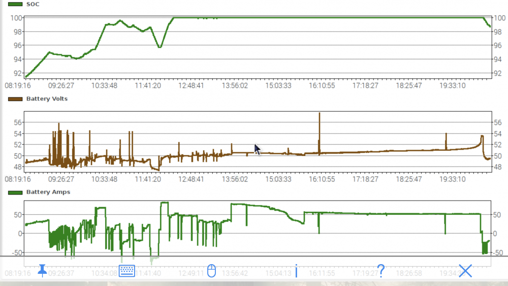

I commissioned my system and the batteries were not fully charged, although the Victron Battery monitor indicated it as 100%. I am making use of the ICC software to trend battery state only. As the system reached 100% during the day the batteries will accept the energy (kW) coming their way up to a point where the batteries actually reach the real 100%. I reached this point after I decided to charge the batteries with Eskom power one Friday. I charged the batteries at a rate of 50A from Eskom and at about 20:00 the Friday night the batteries were fully charged. The Amps drawn from Eskom suddenly dropped to Zero.IMG_3616.thumb.PNG.48b4d8e16c1f006b0b38cf215cd67430.PNG
Since then my batteries did not react strangely to high loads or give strange alarms since SOC (State of Charge) was actually much closer to reality.
I had to disconnect the Victron battery monitor to install a bigger fuse on my battery system and after startup the monitor indicated full batteries again although it was at about 80%.
I'm slowly catching up to the real 100% again but have not reached it yet as I do not want to pump Eskom power into the batteries again.
Yes I agree that the Microcare MPPT's Voltage range for float needs to be changed to accommodate for lower Voltages as my batteries actually require 51V (12.75V x 4) as floating charge. I did a test whereby I set the floating charge to 52.8V and 53.6V respectively and on the ICC software it actually indicates that the float charging voltage is around 50.5V in both cases. (The BMS must have something to do with it)
While you use the battery power every day say between 90% and 50% I do not think that you need anything else as to focus on floating charge voltage. It might be a good idea to charge it once every few months to real 100% but other than that I'm fairly happy with the way my batteries perform currently.
