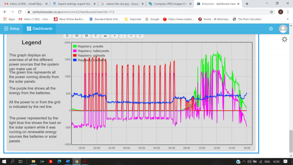

July 11, 20206 yr Author What I see on my ICC. I know just enough to be very concerned. What bothers most is that this started after I tested the system. I.o.w. there was some kind of default reversion to a primitive state. Very threatening. I am in your hands now.
July 11, 20206 yr Cool - thanks for the additional info and screenshots, @Clivevan That helps to better understand what is happening Let me try to see what we can do - and apologies if I am jumping around a bit 1 hour ago, Clivevan said: The RasberryPie bothers me as well. I suspect it is causing trouble and adds no value. I do not understand how it works at all. ICC on the Pi is a great tool to help you better understand and manage your system. It shows you current and historical performance data on your system as well as allows you to make changes to the settings of your Axpert more conveniently than on the Axpert itself 1 hour ago, Clivevan said: I want the batteries to remain fully charged until there is a mains failure. Only then to be utilised. This is definitely not the way that your system is currently set up. If you look at the last picture that you posted, you can see that since about 09h00 this morning you have not been running on utility - as the red line (gridwatts) has been at 0. You have been running on PV (green line - pvwatts) since then. As for most of the time, your PV production (green line) was higher than your load (blue line - loadwatts), the excess PV energy was used to charge your batteries. You can tell as your purple line (batterywatts) is greater than 0. This means that energy was transferred to your batteries (charging). As your gridwatts at that time were 0, it means that the batteries were charged from PV (basically the difference between your PV production and your load then gets used to charge your batteries). When your PV production dropped below your load (e.g. clouds blocking the sun for a few mins), you can see that your battery line went negative. This means that your inverter used energy from the batteries to bridge the shortfall of PV to provide the loads. When running on PV, this behavior is normal and to my understanding not really detrimental to the batteries. After 15h00 you can see that your PV production was consistently less than your load - and hence the system has been running on battery since then. 1 hour ago, Clivevan said: What I see on my ICC The screenshots that you have posted are actually not of ICC itself but of Emoncms. ICC in your case is set up to upload the data to Emoncms for easier access through the web. Do you have direct access to your Raspberry PI? Has a VNC access to the Pi been set up (for you)? I do not really know my way around Emoncms but believe it is just for data representation. To make changes to your Axperts settings you need to access ICC on your Pi directly Gotta run real quick and sort out a few things with the kids. Will continue in a bit... Edited July 11, 20206 yr by wolfandy Somehow pressed submit before intending to do...
