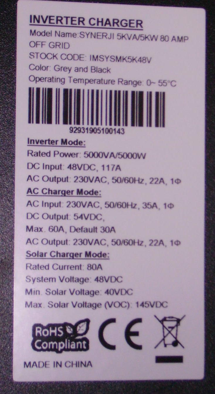

September 9, 20205 yr On 2020/07/11 at 3:39 PM, wolfandy said: You only have a single Axpert installed - correct? I just noticed from your pictures that your inverter is in 'Master' mode ('HS' on the display), which means that it is set to parallel use with multiple inverters. I would recommend switching it to 'Single' mode to avoid potential misbehaving. Happy to post details on how to do this if you require It says the same on my MKS 5K display. How can I change it? I purchased it as a single stand alone unit but it was delivered with the parallel board and parallel connection cables. I did not bother about and left the board installed. By the way, my Axpert on the invoice was delivered with the name Synerji. Is this a re-brand or a clone? Thank you in advance for your advice.

September 9, 20205 yr 2 minutes ago, Beat said: How can I change it? On the OG models it is Menu 28. Just change it to "SIG". (The inverter must be off when changing this)
September 9, 20205 yr Hi @Beat, It's relative easy. Goto setting 28 on the LCD screen. You will not find it!!! You will only see it, once you put the unit in "Standby" mode, i.e. flip the little rocker switch on the bottom on the unit. Then change setting 28 from "PAL" to "SIG" and it will become a slave. You can leave the card in the unit. Save's the hassle putting it back if and when you go parallel. Depends on your future requirements.

September 9, 20205 yr 3 hours ago, Beat said: By the way, my Axpert on the invoice was delivered with the name Synerji. Is this a re-brand or a clone? I do not know. Based on the info from the AEVA forum, I would say it looks like a re-brand - however, I do not understand the comment further down in that post about Synerji. Maybe @Coulomb can help us understand?

September 10, 20205 yr 20 hours ago, Beat said: my Axpert on the invoice was delivered with the name Synerji. Is this a re-brand or a clone? I'm pretty certain that they are work-alikes, not even clones. Though the Synerji label in the photo certainly looks convincingly Axpert-like. Perhaps they have been reading my "own a clone" post, and fixing up every detail. I did worry about that possibility. If so, that would make them more responsive than Voltronic Power, ironically. @Chris Hobson had one for a week or two, and posted a video on its operation. I don't have time to dig it up just now. He was not happy with it, and returned it. My recollection is that the display was different (I recall a yellow backlight, for example), but I think that there were more substantial differences, as well as actual operational differences.
