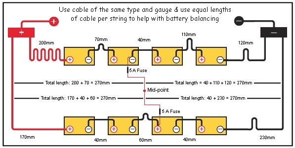

  • It is not about the positive or negative pole, but rather the true mid point of the string of batteries. Parallel battery strings on its own is something to avoid and by tying the midpoints of di

Victron just went nuts - screaming it's head off about a fault (Axpert blissfully unaware of a problem)... 1 battery with 2 cells dead! Wow, completely unexpected on a newish set like this (3/4 months old). Took it out of the bank and test seperately, yup it is screwed. So halved my battery capacity and monitoring the others because Vicron still seems unhappy but I think that is because I have left the balance/midpoint cable in place while testing (obviously 2 batteries on one side and 4 on the other is not a good combo - will go fix now).
Fixed - Now to monitor for another fault in the left over bank, they will need to all balance first.

I think the issues were related to the batteries, They were wrong for the system in the first place (Ca/Ca so Axpert cannot deliver a proper equalising charge (needs 63V, Axpert max is 58.4). I think the 2 dead cells created the problem and the issue I had with reading the midpoint - Didn't expect that the batteries would already be faulty when I connected the BMV, and that there was one on each side of the midpoint in each bank. I think it was only when the 3rd one hit graveyard (probably because it was compensating for the dead cell), that it became so obvious. Might still be able to recover the 3rd one with some care.
Without BMV and midpoint connection, the problem would have run on even longer. Even with the midpoint it was missed for a while because the faulty were on either side of the midpoint, and the fact that I was still getting to know/understand the unit.
I have the same setup with my batteries but I see you have a wire connecting battery2 neg to battery7 pos.
I do not have that cable in. I believe it is for the victron midpoint reading.

This is the layout of by batteries, 2 banks of 4 on top of each other.
What is the best way to connect the BMV 702
According to the install instructions, which I followed (except for mistakenly having the shunt the wrong way round for a while):
Shunt is connected to battery negative, the other side goes to the invertor. B1 is then connected to +ve (48V) and B2 (the midpoint) can be connected to the mid/middle point (where 24V point would be). The middle points of each bank are then connected together. All cables to the shunt and the B1 & B2 points should be exactly the same length (so that there is limited diference in voltage drop across the battery cables (especially under load). Setting 69 on the Victron must be set to Mid. The Shunt can easily be installed the wrong way around, which won't harm anything, but the readings will be wrong and will show negative values instead of positive for the current readings and also the % values will seem to be going the wrong way. Look carefully at the drawing (it isn't mentioned anywhere else in the docs, so got me very confused until set right by some of the people on this site).
