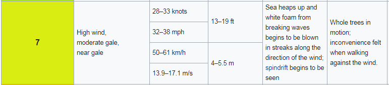

Read this https://en.wikipedia.org/wiki/Beaufort_scale
From my experience with a wind generator, you need Beaufort 4-5 or above to generate any power, so the wind must be bending the trees. Where I am that is just too intermittent to produce any noticable contribution to my power needs. In a city (which one) there is lots of interference from buildings, trees etc, so I doubt you will have much success with wind, unless you are in a really exposed position.
26 minutes ago, Muchachos said:
My area is 3m/s average and close 7m/s on windy days.
I think this answers your question. Wind power goes up with the square or cube of the wind speed, so at 3 or 7 m/s you will probably be producing nothing. If you can put your hand up to the wind and feel a push, then the wind has some power, otherwise not.

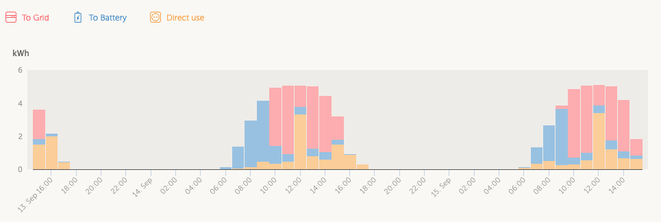

This is the current utilisation on the solar charger.

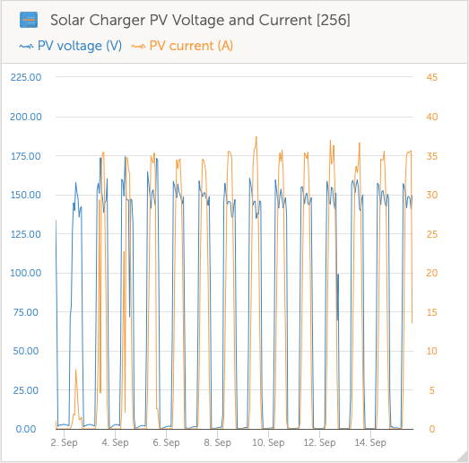

This is the PV generation pattern.
Can I add 4x405W East Facing PVs and 4x405W West facing panels to this charge controller without having problems?
From graphs I am going to go with a daily peak power from PV as 150V @35A, say a nominal peal power input of 5250 Watts. (In line with what you said).
I'll guess your charging voltage is say 55V and you have 100A at that voltage, so you are capable of handling a peak of 5500W'ish.
So you have around 250Watts of headroom in your present configuration. Which isn't much.
Essentially you can't add any panels (N or normal slope E/W)  that add to your noonday peak. You won't have problems, but you won't reap a whole lot of benefits either.
