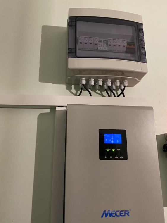

Hi John, easiest way is to connect with a combiner box, this will already have the parallel connections in as well as fuses for every string. They also include a DC breaker. I attach a photo of my setup. This combiner box is for 4 strings.
6mm Solar cable will be sufficient
