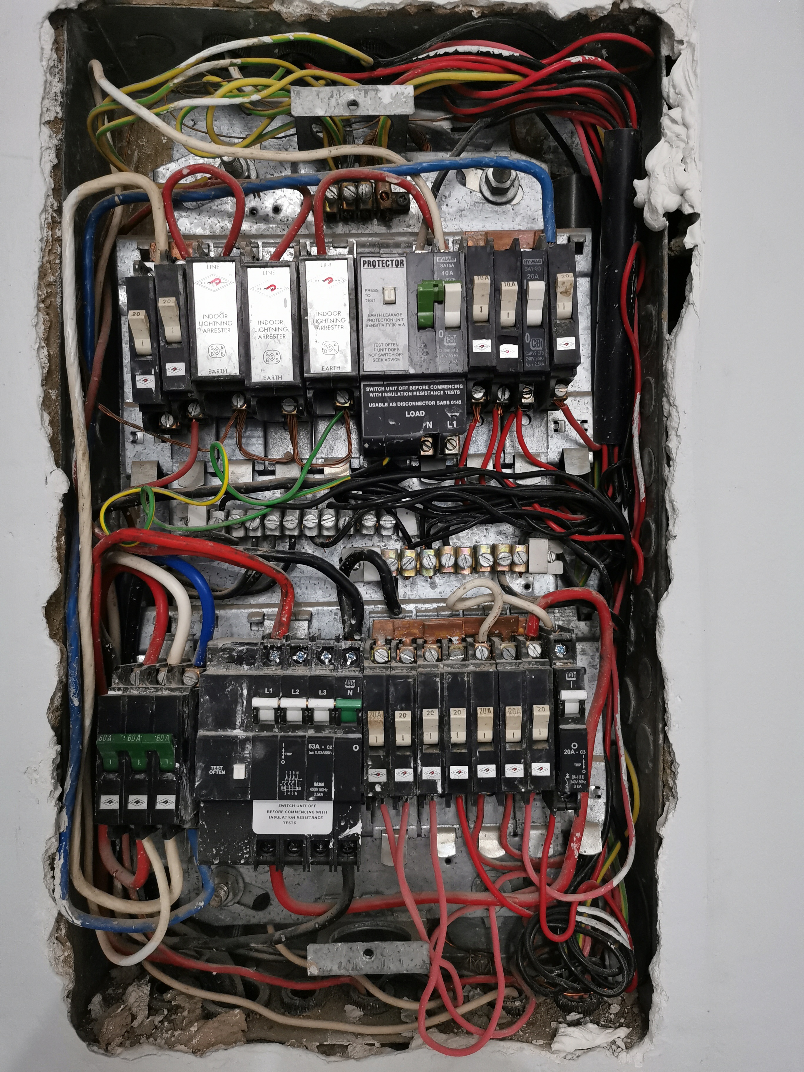

Hi guys
Where did you attach the efergy transmitter? To the main meter (which for me is outside my property and far away so not sure signal will reach) or can it be connected to the DB in the house?
If it can be connected to the DB where in this mess do I connect it?
Thanks!

That looks like 3 phase. How many CT clamps have you got? If only one you'll need to pick a phase to measure (the cables coming out the bottom of the main breaker at the bottom left).

Thanks Speedster, yes 3 phase and I do have 3 clamps.
Thats where I thought they went but the part that confused me is that there is a second wire going in on the far left terminal. More clear in the below photo hopefully. Can I just ignore that second wire (white one) or should the clamp go around both?

I'm not sure how the efergy will read two cables running at the same time? Perhaps our more learned forumites can answer that. You could perhaps put it on the incoming cables - i.e. at the top of the main breaker?
