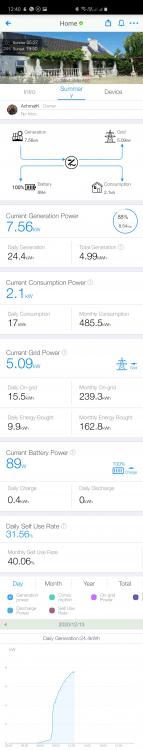

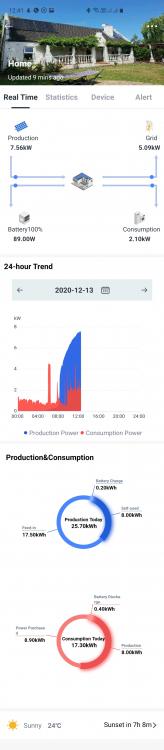

Different Sunsynk Solarman apps, pro's and con's
Differences are mainly in how the data is presented. I mainly use the Solarman Business or Solarman Smart apps.
Screenshots below if the different apps.
Solarman Smart app.
Solarman Smart app.
1116662710_Screenshot_20201213-124113_SOLARMANSmart.thumb.jpg.69b127ec1326441eb00573acc56c3a54.jpg1006688281_Screenshot_20201213-124133_SOLARMANSmart.thumb.jpg.9c7ebc0f0727866bc07f80056924f16c.jpg
Standard Solarman app
Solarman Pro app
Screenshot_20201213-124002_solarmanPro.thumb.jpg.24782ed2d938588079df8fe0cdc62312.jpg
@Achmat what are your settings on Solarman Smart app to show battery and consumption. Mine only shows production, grid and consumption and I'd really like to see the battery.
Thanks Margaret
Thanks Margaret
Hi @Margaret
To answer your question, to see the Battery info I think your plant's "System Type" needs to be set to "Storage System" as shown in the screenshot below. You can change this setting in the Smart App by selecting the three horizontal dots at the top right corner of your screen when you are looking at the "Real Time" data of your plant. Under the three dots menu you'll see an option for "Plant Info" and then just look under the "System Info" section for the "System Type" setting.
I hope this helps...
