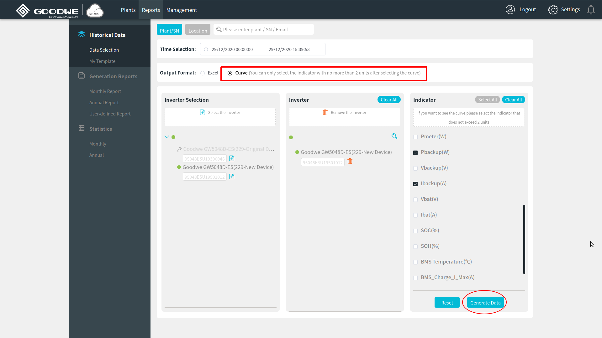

You could perhaps also generate a graphical report from SEMS from the time you are having issues, suggest start of with a wider date range, I also suspect SEMS is based on a time zone in Asia so you may have to select a time a few hours ahead for a recent event:
Make sure to select curve along with max 2 parameters (when generating a curve)
You can Zoom in and out of the area of interest using the sliders below:
