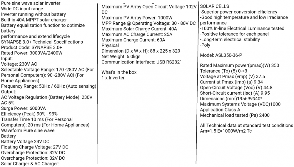

brilliant, thanks for the replies, sorry im only getting back to you now, hectic week, late nights.
i took screenshot of the specs, if its not enough i will go find the booklet.
please see attached.
i dont know our exact usage per day, but our towns power was off the other day for repairs to overhead lines and
we had inverter power for the whole day.power.thumb.png.2870e28682d2fcb8d92778e07bbf1c66.png

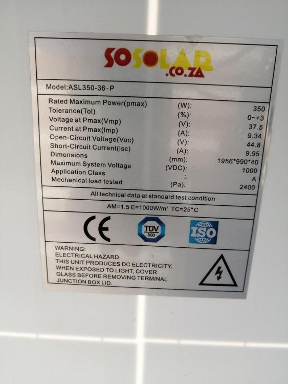

Thank you. The key figures are:
Max voltage of the string/s: 102V
MPPT range: 30-80V
Max power: 1000W
Any panel configuration, whether serial or parallel or a combo should never exceed 102V, because it will burn. I'm not sure if the MPPT will clip the amps, so let's assume it does not, best not to exceed 12.5 A
For new panels, follow the steps in this guide: https://unboundsolar.com/blog/string-sizing-guide
If you want to re-use your two 350W panels we will need to know what the specs are, usually supplied with them:
1. VoC at STC
2. Vmp at STC
3. NOCT operating conditions
4. Temperature coefficient of VoC
I am guessing that they are around 47.8.V VoC and 9.8A Vmp, and that they are in series, which does not give you room for adding another panel (you are already at 95.6V).
