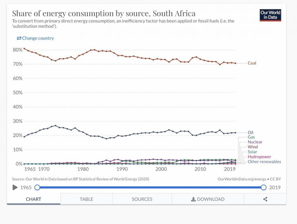

How much energy do people consume monthly. Well as always it depends. To make things easy, see my promise earlier, I will use 500kWh per month apart from 3 winter months that will be 1000kWh consumption. This is so you can easily extrapolate and make it work for whatever your numbers are. For electricity kWh costs, I used a number as it varies all over the place depending on supply and where you are and pre-paid or other wise.

Different view, by source.
1398074118_ShareofenergyconsumptionbysourceSouthAfricacopy.thumb.jpg.1415e81331a045b0bcef3f9388effd04.jpg
It appears that we consume on average about 20% of energy as electrical energy, the rest from other sources like LPG, Petrol/Diesel, Wood, Coal etc. Average electrical energy consumption per low income person is around 4kWh per capita (i.e. per person living in the house). For middle income people it could be around 8kWh per person and the well heeled sometimes consume around 25kWh per person per hour. For a family of 4, 20-30 kWh per day are deemed to be average for SA. Remember, this is very dependent on the individual’s choices and situation.
From the above, the utter lack of transitioning to cheaper Solar Wind Battery Storage (SWBs) by 2019 is clear, and the initiatives to build any REs, way too late. Much the same still now.
