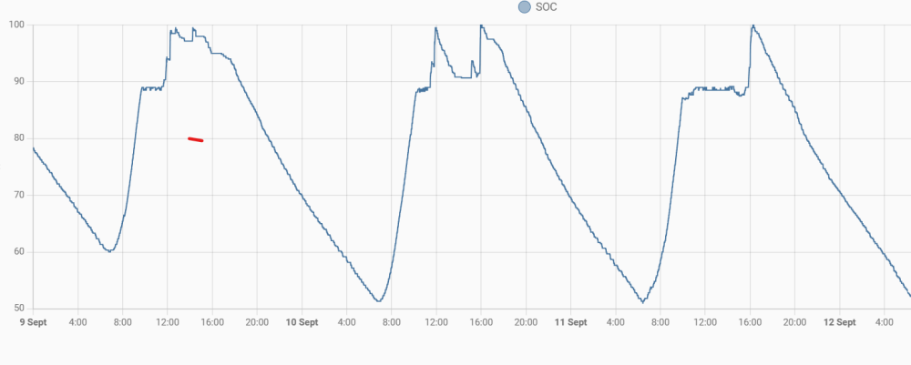

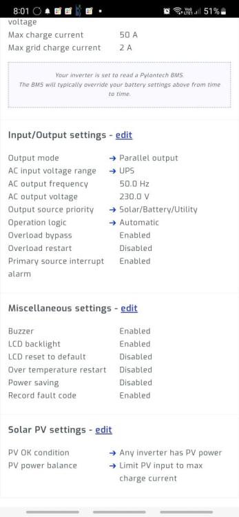

I have noticed that the setting to limit PV input to max charge current seems to be set by default. I am not able to change this setting in solar assistant or on the inverter itself.
It seems this setting is cutting the solar input on my system once the SOC passes somewhere between 89-95%. I tested it to see if this was the case. I used a higher load to keep the SOC under 90% and there was no characteristic drop off in solar that you can see for the preceding days. This seems to cut off 1500 -2000 odd watts per inverter (4000w array x 2 for parallel inverters). During this period the inverter will use the lower solar power in conjunction with the battery to cover the loads. This is even more visible when the battery is fully charged and the solar input is limited to about 1000w per inverter until the SOC falls under 97%.
During charging of the battery under 89% I get a peak solar input of roughly 6000-7000watts which I think is ok for an 8000W array?
I never noticed this issue when I had the charging values set manually only when I connected the communication with the pylontech BMS.
That is a very interesting observation. I'm running a kodak 3.6kw battery, which is setup to use pylontech setting. I've noticed an under read of amps on my inverter. Eg. Battery reports 54v charging at 49amps inverter records pv input at 65v with 30 amps.... And battery charge is set to solar only.
I also can't change my solar assist setting, but my setting is opposite to yours. What if you disconnect on solar assistant as if you were going to change an advance battery setting can you then change it?

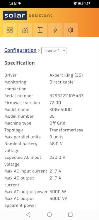

can you confirm that the Kodak og plus 5.48 is correct for this firmware?
Yes, it's suitable. Patched firmware version 72.00a is based on factory firmware version 72.00, which is what you are running now. So you should have no problem. You will need to update the display firmware as well, so you'll need to get the USB to RS-232 cable all sorted. You could start with updating the display firmware first (this patch requires both firmwares to be updated). In the worst case, you lose the ability to use your removable firmware and monitoring, but power should still flow.
The only compatibility issue is with the display firmware. There is a very small chance that your display firmware uses the other chipset. I've not heard of Kings with the other display chipset, but it's possible. As long as your display firmware is a well-known version like 02.81 or 02.83, you should be fine.
