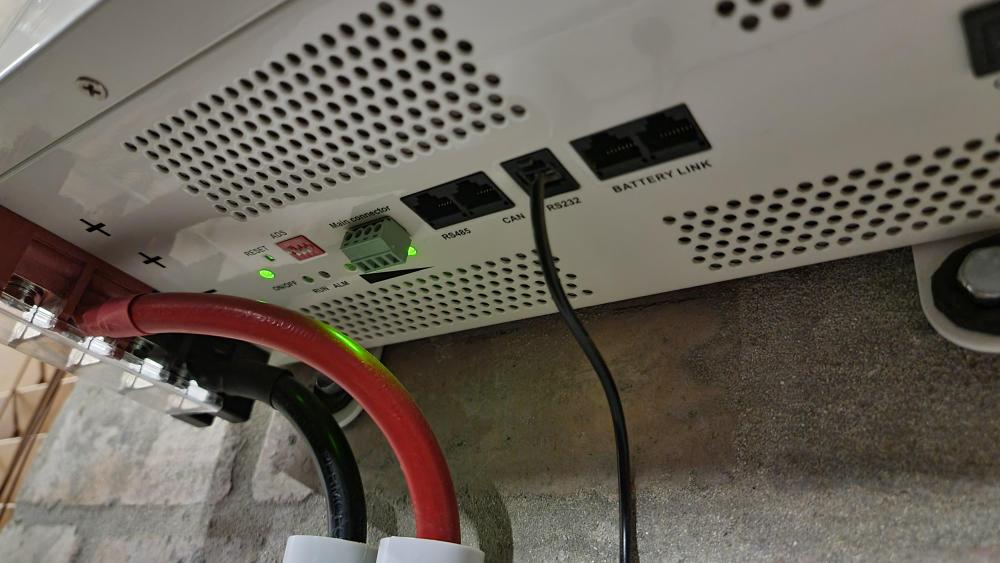

I installed the AM2 battery with a Kodak King inverter. The grey comms cable supplied by Hubble is connected to the battery CAN port, and to the battery port on the inverter.
How do I check that the two are indeed talking?

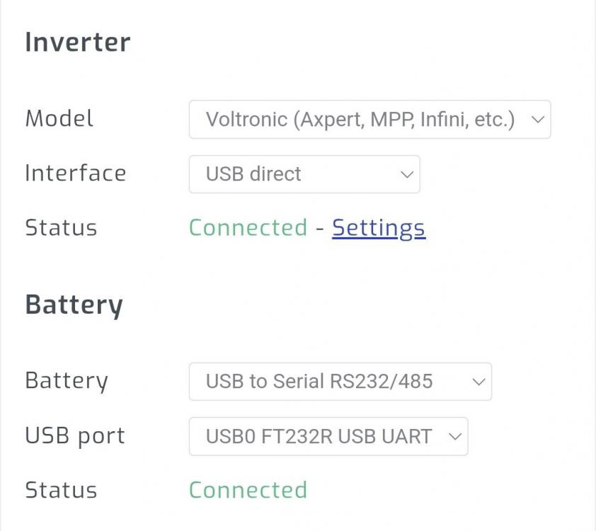

Can you confirm which port you are using on the Hubble AM-2, the RS232 port, or the RS232-Can port? Do you know if you can use both? RS232-CAN to Cloudlink, and RS232 to Solar Assistant?
On 2022/05/06 at 9:23 PM, Mier said:
SolarAssistant can communicate directly with the Hubble BMS. They also sell the cable on their website
Thank you. Cable ordered delivered and plugged in!
