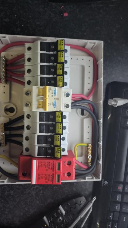

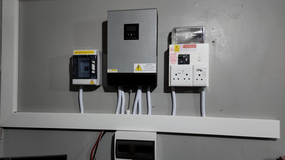

June 6, 20224 yr Hey all, So i started working on my diy solar setup and think I am starting to get somewhere Axpert 5000 80a 145v one. 8x330w solar panels in strings of 2 (Planning to get another 330w and do 3 stings of 3 later ) DIY combinder box still looking at getting a busbar that will fit between the fuses. 2x pylontech us3000c Keto 125a battery disconnect 1xEarth Neutral bridge box And then a db ready board for after inverter. I have everything connected exept for the Earth Neutral bridge box. I am a bit confused on how to connect this one to the setup and dont want to blow the relay or worse. Any one here have one installed that can provide a bit more info on wiring it up? Some photos below this is the db after inverter I have a seprate braker in the main db comming in to the inverter direcly. Please let me know if i am still missing something here as well. I still need to earth my pannels as well as it currently is not and not sure what the best method would be.
June 6, 20224 yr Hi Riaan, glad you took the plunge and had the courage to start this. The Earth to Neutral relay is not a requirement if this is a genuine Voltronics machine. The Inverter has this inbuilt. In the event of a fault the Inverter will tie Neural to earth. Effectively what the Relay you are installing will do. On the question on Earth Bonding for your panels. The panels can be earthed to an external earth spike.
