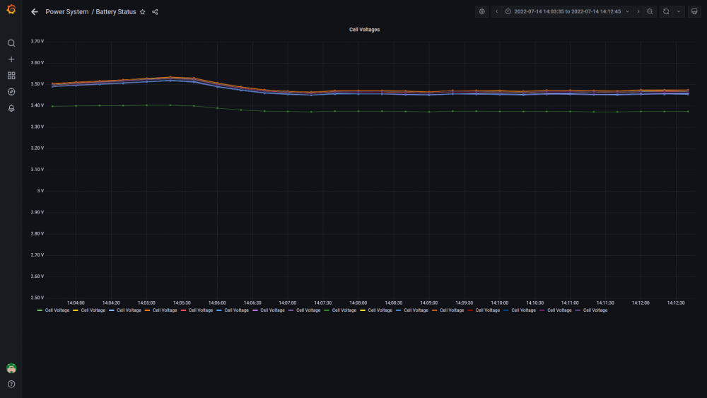

I have the same issue with them, and I have the archived data to prove it.
They told me exactly the same, bring the battery to them and they will look in to it. that would mean myself having to travel +_ 220 KM return trip leave the battery there for +_ 2 days and travel another 220 Km to fetch back, not even considering the expense of getting my installer to come disconnect/connect the battery. And with load shedding on a daily basis been without power for about 4 hours a day.
see dashboard bellow cell number 8 does not reach full charge.
Does cell 8 get depleted first? If this cell has more capacity than the rest it will not reach the top voltage. My battery pack does that too, I also have some cells reaching 3.55V and others still on 3.4V but I am getting more than the promised 10KWh. What matters is that you get the full stated capacity from your battery.
If you charge it showly at 5-10A  you can balance the cells nicely over a couple of days. It needs to charge at a low current to enable the pack to top balance
The Cell voltages is simply an indication of how well top balanced the pack is.

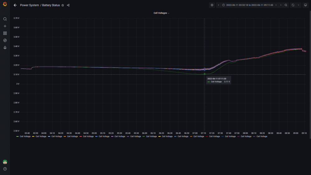

@iiznh yes, it does, check dashboard, it's very seldom that I discharge my battery bellow 40% however, there was an instance that I dropped bellow 10% SOC, there it is.
Most definitely cell number 8 has a problem.
Cell 8 seems is unbalanced with the rest of the pack, that does not say it is a problem cell.
Have you top balanced your pack? Charge it to 95%, then charge it from grid slowly with 5A till you see cell 8 rise to 3.55V, it will give the pack some time to top balance and will allow more energy to get into cell 8, this might take a couple of days depending on how big the mismatch is. The Daly BMS only balance cells while there is a charge voltage and current is flowing. If it is properly balanced cell 8 charges slower than the rest then I would say it is not well matched to the rest of the battery pack.
If you charge the cells with high currents or never fully charge the pack and give it time to top balance, cells tend to drift
Sorry I bought DIY cells for the exact reason that I want to be able to self-service the pack, they have performed well even though some times of the day I hit them with plenty current, once the shade hits my panels then the remaining 5A works nicely to balance the cells
In my case its cell 2 that is the problem.  What happens is after about 15 minutes cell 2 voltage drops to about 2.8v and I see a current spike of 72 amps on the logs. The SOC then drops down to about 10%.  I suspect there may be another cell thats on its way out but I will first replace C2 and then monitor the battery and see how it responds.
The voltage of a cell shows a complete different picture when being charge and discharged. If you are not prepared to top balance the pack, no amount of swapping the cells will fix your problem. The only voltage relevant is 3.47 - 3.6V when charging with a low current that indicates a cell is fully charged. Any other voltage means it still needs current.
If a cell is not well matched to the rest of the pack you will struggle with it, swapping it with another random cell bought online will most likely give the same results. So I'm starting to understand why they cannot simply send you replacement parts.

This what mine looks like after replacing C2.
